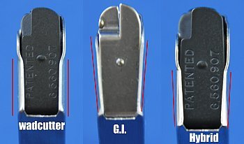

Here's a picture of the different magazine lips. This may help you.
From your picture it looks like you have hybrid lips on your magazine. Even though they may be from the military doesn't necessarily mean they are GI lips. Also, is that a plastic follower in that mag ? I have never used anything but a metal follower. If plastic could it be that the follower is rubbing on the inside of the mag or getting twisted and hanging up? One other thing, does this only happen when you load 5 rounds? Does it do the same thing when you load only 4, or 3 or only 1 round?

Yea, I think these wilsons are the Heavy Duty Combat mags. The follower is plastic and domed on the top. I'd be interested in trying those wadcutter style. By functioning the slide slow and by hand it does look like the mag is releasing the rounds late in the process. I loaded 6 dummy rounds and each one got the dent...Not as bad as the first one but it's still there. I think its gonna happen by the nature of it hitting the feed ramp. With a hard cast bullet you cant even tell. If I can get the same accuracy out of a 200 SWC Hard Cast then guess what I'm doing...LOL.

The wad cutter style will release the cartridge the latest of the three different lip styles. The GI will release the fastest/soonest and the hybrid somewhere in between. I would think that the WC style would make your problem worse.
