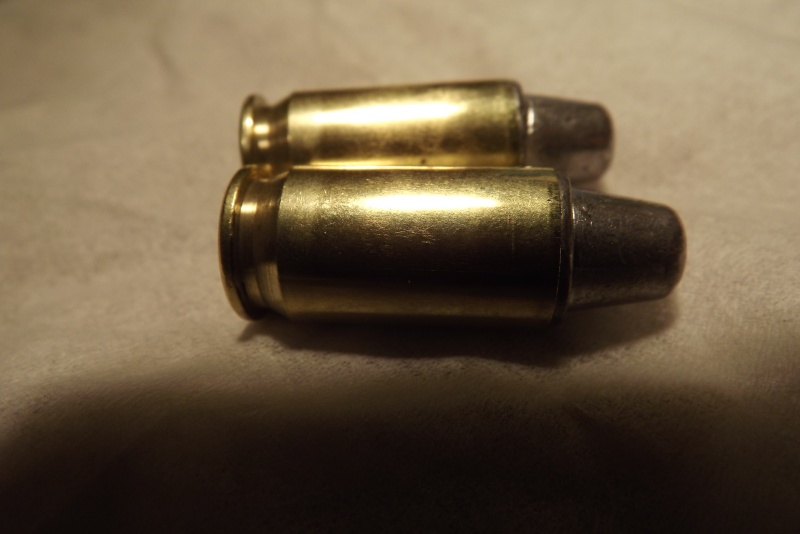

Rob, ive run many thousands of powder coated with loads as low as 3gr of BE
but almost all of them were LPP
ive only run these SP brass thru a few times and i mostly use fluffier powders red dot,700x and the like,
i dont really use BE that much, i guess ive been holding back my stock while i use up the other powders i have
that bullet in the picture has been squeezed by the bore, its at .450" the size of the bore in the Kart barrel
they started life at .452"
now remember that bullet was probably run at 300fps or something very slow like that
so it wont show much evidence of powder burn
i reassembled those 50 that i pulled (remember everyone had the proper amount of powder)
and i ran them out today (mostly in my .45scp revolver)
i had 1 of those that went pppfffttt and the bullet hit the target and landed on the berm
i have it on my desk. i heard it go POP and i heard it smack the target SLOW!
here is one thing that i didnt attribute to any thing but i bet its the cause
the butt end of the bullets when i pulled them had a coating of powder on them from static charge on the polyester coating
it fell right back in the case when i brushed it off.
im betting that that powder (im sure 1/2 gr or something tiny) was the only powder that ignited in those pppffftt rounds.
the primer fires, its blast hits the bullet butt and ignites that bit of powder and doesnt ignite the rest of it laying way below
the flash hole,as i had seen plenty of unburnt powder in the bore after a pffffttt
it couldnt be just the primer driving the bullet out the bore thru the target and down range
so we had to have a bit of powder helping out.

yes i had to rebell to drop them back in (and my bullets are SOFT so i bell big and deep)
and i recrimped them to .469" as i do
you wont see anything on those bullets they just dont show it
that top band is very narrow
im sure if these were the H&G #68 style you might see something on the top band
here is what that batch looked like when i first loaded them

Your right. That is a very narrow band. Your camera skills put mine to shame but this is what my taper crimp looks like. Lot's more noticeable.

yeah Rob i do cast and coat my own
and i had planned on seeing if just a primer would run one down range i dont think so....but... it would be fun wouldnt it
the barrel in my 1911 slugs at .4501"
and both of the recovered bullets are just that size
i shot up the rest of the bad batch
and the ones that i reassembled
and shoot nicely they did
except for that 1 round
as a test i will do the same load, same bullet but LPP
and see what i find
i bet they will just shoot perfectly

my eyes are old, but, I still don't see where that bullet sealed the bore......
- Posts : 6081
You won't
james r chapman wrote:my eyes are old, but, I still don't see where that bullet sealed the bore......
I expect (but have no proof) that the coating is perhaps somewhat elastic and that you won't see the 'normal' evidence that the bullet sealed to the bore. When I looked at the picture it reminded me of all the 'hoopla' about moly coated rifle bullets a decade or so back. The pictures of fired moly coated bullets never seemed (to me) to have fully engraved rifling on them. Of course they did shoot, otherwise there would not have been so many singing their praise......haven't heard much of that song lately though.
Bruce
Fire Escape- Posts : 223
Join date : 2013-06-23
Location : New Hampshire
Re: lets talk ppppffffttttt ! err.... pop!
since these bullets are bigger than the bore when they are sitting in the case
they must seal the bore
there wasnt enough pressure behind that bullet
to swat a mosquito
to swat a mosquito

Can you post a picture of your slug from slugging your barrel?
- Posts : 6081
james r chapman wrote:Can you post a picture of your slug from slugging your barrel?
nope its been smelted and turned into bullets
but i can do it again
