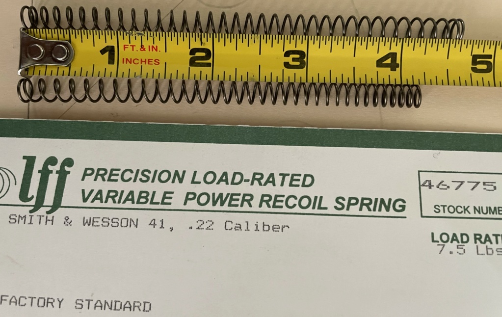

I ordered a Wolf Factory Standard 7.5 Lb Model 41 spring Friday.
I also have a S&W Model 41 recoil spring I ordered from Brownell's last winter.
top spring in photo
S&W Factory spring (part # 940066820)
~ 4 5/8"
0.029 wire
36 coils
0.270 od
Bottom spring in photo
Wolf 7.5 Lb spring
~ 4 3/16"
0.031 wire
36 coils (22 equally spaced and 14 closer together)
~0.265 od
My recoil guide rod measures ~0.193 (the 0.265 OD Wolf spring with an ID at ~0.203 slipped right on)
top spring in photo
~ 4 5/8"
0.029 wire
36 coils
0.270 od
Wolf 7.5 Lb spring
~ 4 3/16"
0.031 wire
~0.265 od

The Wollf spring is a “Variable pitch” spring. The advantage is that there is less “preload” at the installed max dimension. The fine pitch will compress “solid” first. So it ends up as a “variable spring rate spring”.
