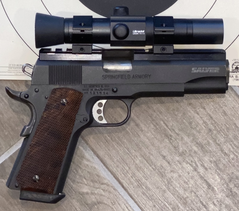

Last Winter's project gun. Started with a new 9mm SA RO from my LGS. Tightened the slide/rail fit using method 2A in the Kuhnhausen manual. Fitted a Fusion 1:10 match barrel, and an 0.001" over/under size EGW angle-bore bushing. Other EGW parts: ball-end disconnector, 0.200" slide stop (I kept the factory link...I could probably go one size shorter though), and enhanced sear spring (set-up for 4#). C and S parts: ultra-match hammer, super-lite sear, oversize hammer and sear pins, and 1-piece guide rod. Wolff recoil (8-9#) and 15# mainsprings. Rail (fits over the stock sights) and trigger shoe by Froneck. "Antiqued" rail finish by me. Tripp (Dawson) 9mm magazine. Smooth grips (from Amazon) that I then finished, then added the grip tape for my sweaty hands. It shoots pretty well, posted a target pic using the rail/dot in the Ammunition discussion under Ransom vs. Linear Slide testing. I load 147 JHP gr bullets (Zero, Magnus, and XTP) and ~3.0 to 3.2 gr. of fast powder for a ~875 fps subsonic soft shooting round. Only thing left is some trigger work. The C and S trigger is not bad, but I'd prefer a little less roll. About $650 in new parts (excluding the Holosun) plus the pistol. Roughly 20 hrs spent doing the handiwork. Interesting: fitting a barrel/bushing removing (polishing) small amounts of material as the barrel goes from being "sprung" to a precise non-binding fit. It felt like I was removing a tenth or two at a time (disassemble, polish, reassemble, check, repeat...). I was fun to do this. 1911's are much more interesting than AR service rifles.

I did the same thing. Kinda. I took it apart probably 50 times getting the hood and link fit right. I also used a Fusion 1:10 twist match barrel. I spent the extra dime and got the threaded barrel. I should also mention I got the barrel in 38 Super. Last week I took it to the range and tried to find a decent load for all my 147gr LFP. I found out you can shoot them too fast. My 4.6gr Bullseye loads (which my 1:16 twist likes) were actually keyholing. I suspect the 3.6 will be better but I'm heading back with a full set of recoil springs. It turned into a single shot...

3.6 BE maybe with a 9 or 10# spring? I'm using Alliant e^3. I'm using Fed 100 primers so I went with the lightest mainspring. I also kept the factory rounded-edge firing pin retainer. Do you recall what the factory link size was? I never measured it. Also, what tube size is your Sightron? I had an odd sized 33mm Sightron but I sold it.LenV wrote:I did the same thing. Kinda. I took it apart probably 50 times getting the hood and link fit right. I also used a Fusion 1:10 twist match barrel. I spent the extra dime and got the threaded barrel. I should also mention I got the barrel in 38 Super. Last week I took it to the range and tried to find a decent load for all my 147gr LFP. I found out you can shoot them too fast. My 4.6gr Bullseye loads (which my 1:16 twist likes) were actually keyholing. I suspect the 3.6 will be better but I'm heading back with a full set of recoil springs. It turned into a single shot...

30mm tube. I also sold my 33mm scope.the link is not marked but I'm pretty sure it is a 4. I also have a .200 Fuzion slide stop. That barrel came super rough. I spent quite awhile just polishing the ramp.

Update, I wish I had a glowing report. I've solved all the failure to feed problems that were caused by sharp edges and a very rough ramp. I just can't get it to cycle with anything other than max loads and even that is iffy. Heading back to range soon with plan 37. I've changed the #4 link with a #3, put in 10lb recoil spring and left the muzzle brake off. I know I'm doing 3 changes all at the same time. Not my normal procedure but it will let me know if I'm wasting my time on the Fusion barrel and put the Sig back in.
