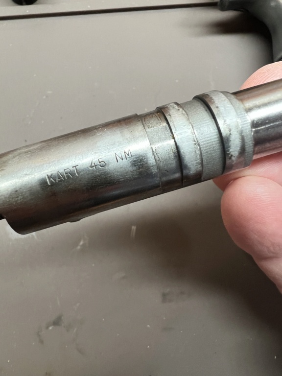

Hello, I have an unmarked Wadcutter gun that I suspect was built by Giles. It has the hammer, front stippling, and rear sight-scope base modifications that I've seen on marked guns. Mine also has a Kart barrel that has a flat filed at 12 o'clock, and the slide bottom has been filed for clearance rather than the receiver "dust cover." If any of you have a Giles gun, I'd appreciate your comments on my photos.

Not enough information. Need to see complete pistol photos. I doubt Giles built that because I’ve never seen original Giles with Kart barrel. Is there a welded tab/shim on slide on left upper side across from ejection port?

I’m guessing it was a Giles originally. The rear sight has/is a bar/stud that the original Giles Wagon Wheel iron sight rib was held in place with. Giles also sometimes lightened his hammers. Looks like your Kart barrel is making full contact with slide lugs, so the tab/pad that is usually welded on the slide has probably been removed. But Giles also shimmed upper barrel lugs on some pistols.

The stippling on the front strap is identical to mine. It looks like it started out as a Giles gun and someone replaced the barrel and rib to modernize it.
