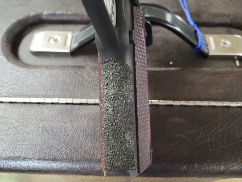

Post by NukeMMC Tue Jan 17, 2023 5:56 am
I prefer stippling. The Navy pistol armorers used to do it with a pneumatic engraver. I do my own with a Power Custom frame support jig, 4oz ball-peen and drill rods that I have ground different points onto. It takes time and practice, but the feel is perfect FOR ME.
Do what YOU feel most comfortable and confident with.
