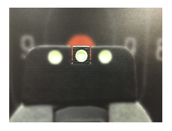

Post by shootingsight 1/31/2023, 2:24 pm
I did not, and have not, ever suggested that the target should be clear.  However there is a degree of blurriness that is so severe you cannot judge the center.  This is why you cannot shoot a +1.25 diopter correction.  So the trick is to get the target to the maximum tolerable blurriness without going too far.  The Zins video above shows this - there is a shot where the camera is focused ON the front sight - the target is much too blurry.

Post by mikemyers 2/1/2023, 4:34 pm
shootingsight wrote:I did not, and have not, ever suggested that the target should be clear.  However there is a degree of blurriness that is so severe you cannot judge the center.  This is why you cannot shoot a +1.25 diopter correction.  So the trick is to get the target to the maximum tolerable blurriness without going too far.  The Zins video above shows this - there is a shot where the camera is focused ON the front sight - the target is much too blurry.
Glasses for bullseye  - Page 2 Img_6610
Two suggestions - before I say this doesn't matter.
First, try shooting at a target that is mounted backwards, as suggested earlier, so there is NO bull to shoot at, and then look at the target later from the back.  You may find you shoot a better group that way than the normal way.
Next, let's say you've got perfect sight alignment, and the gun wanders back and forth by 1/4".  If your sights remain properly aligned, you will still shoot a good group.
Glasses for bullseye  - Page 2 Scree115
As to not being able to aim at the very center of the target, that is irrelevant.  The ONLY thing that matters with open sights is to keep the sights in perfect alignment.  ....and of course, to not jerk the gun or flinch or do any other things that will make aiming irrelevant.  I forget who posted this link long ago, but it is worth watching, and understanding, and remembering.
