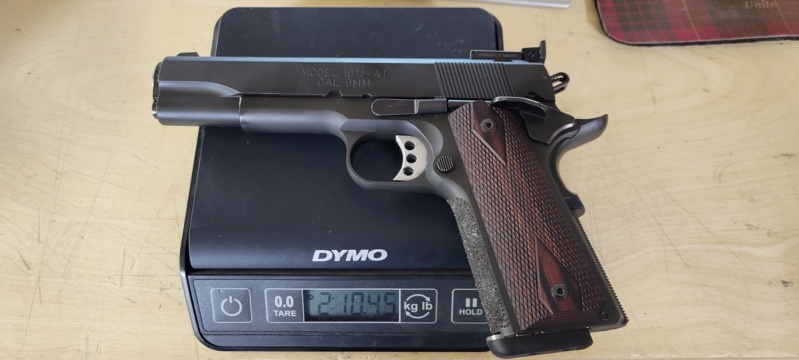

Post by NukeMMC 5/24/2023, 12:53 am
CMP Service Pistol Question 20230512
Dcforman wrote:In theory, a 1911 in 38 special can be service pistol legal. But it still needs to come in under the 45 oz. weight limit with a magazine. Tough with that thick barrel! Mine with a bomar is at least 3 oz over....
My SA RO 9mm with the ramped Jon Eulette KKM 38super barrel and magazine is 42.5 ozs.  No rib on it but the LPA-cut adjustable sights work just fine.
Load the 38supercomp brass with a Brazos 150 LSWC and 2.8-3.0gr of Bullseye and it sure does feel smooth in TF/RF.  I never shot a 38spl 1911, so cannot compare.
