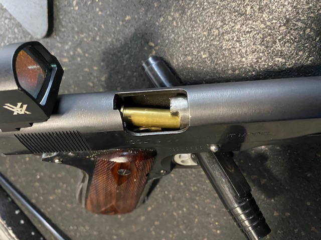

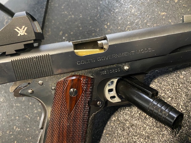

I have two Colt 38 Specials. One is the old blow back design and is pretty reliable. The other is a newer 1911 38 special that I am lucky to get through a magazine without a problem. The front of the round will be low of the chamber. If I pull the slide back about a 1/16 of an inch the round will lift up and slide right in. The slide will lock back after the last round. Any ideas?
Colt 38 Jams Img_3010Colt 38 Jams Img_3010Colt 38 Jams Img_3010
Colt 38 Jams Img_3012
Colt 38 Jams Img_3011

Check the feed ramp from receiver to barrel ramp. Is it catching there? Should be a space approx 0.030”.
Also mags look like releasing early from the pics.

Dumb question, I’m uneducated on the 38 spl 1911, are these wadcutters and roll crimp?
I’m guessing that the rim is under the extractor hook, but it’s hard to see how with that weird nose dive angle.  I’m intrigued that pulling the slide back 1/16” frees it up.  Magazine timing comes to mind. Wonder if you need to tune a mag to the gun?  One that works in the blowback may be okay with how the lips are set.

Jon Eulette wrote:Check the feed ramp from receiver to barrel ramp. Is it catching there? Should be a space approx 0.030”.

Post by Jon Eulette Sat Sep 16, 2023 7:07 pm
Rear of case is released from feed lips at the rear lips. Those lips do not need adjusted. It’s more of a timing thing based on the length of the lips.
Not easy to internet explain. 38 special has timing involved in several areas.

Might want to try some 38 AMU ammo and see if same thing happens.  The 38 Special ammo tends to tip forward in magazine due to the rim.  Same concept as using 38 Super Comp or 38 TJ brass in a pistol chambered in 38 Super.

That’s the worst thirsting job I’ve ever seen on a pistol. That is most likely why you’re having issues. 38 special is most unforgiving cartridge to feed in 1911. Feed ramp must be perfect. That’s frightening!
Get a pic to me of that on your lower fully seated on receiver and to the rear. Angled pic showing both feed ramps; receiver and barrel.
