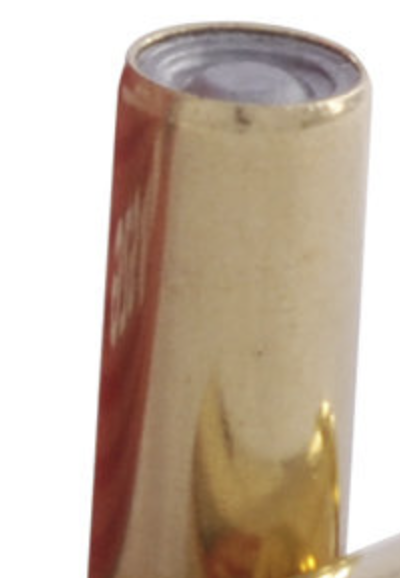

NO need for crimp measurement. Also, you do know it is a ROLL crimp?
You can do two things?
Use a factory WC round to set your Redding Profile Crimp die (you do have one, RIGHT?)
or
Adjust until the transition from bullet meplat to case feels smooth.
I find a VERY slight turning of the case mouth into/over the bullet improves feeding/accuracy. All of my bullets are seating just barely under the case mouth.
Look at the Fiocchi picture.

Crimp on .32 S&W Long wadcutter. <a href=Crimp on .32 S&W Long wadcutter. Screen-Shot-2018-10-13-at-22-46-41" />
Your picture shows a much greater crimp than I use, so maybe that's the answer. I have no idea what the difference is between a roll or a taper crimp. I currently am using a Lee Factory Crimp Die if that helps.
