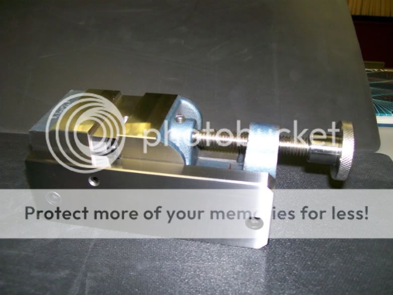

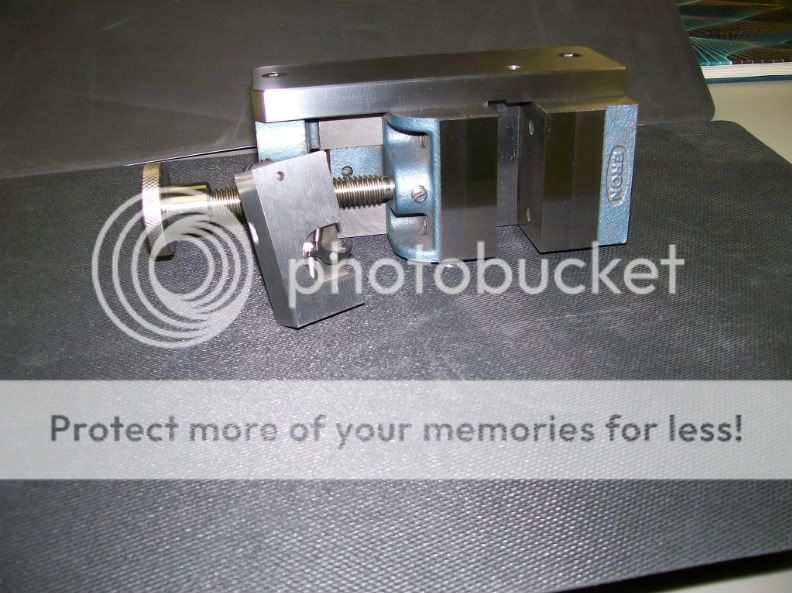

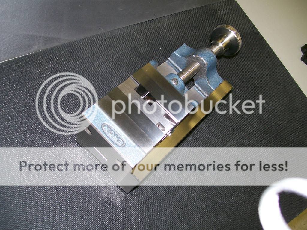

If one is determined to use angles, get ready for a struggle. It is very difficult to get right. IF, it ever is. Below are  photos of the best angle fixture ever. It is infinitely adjustable, and does a fantastic job on hammer hooks.
This an Al Marvel prototype I built off Al's design..Only three exist, to my knowledge.
So, what I am saying is, doing angles without the aid of some above average equipment can be a super challenge..
Powers sear jig tips Fixtures1911Class349
Powers sear jig tips Fixtures1911Class351Powers sear jig tips Fixtures1911Class352
Powers sear jig tips Fixtures1911Class362

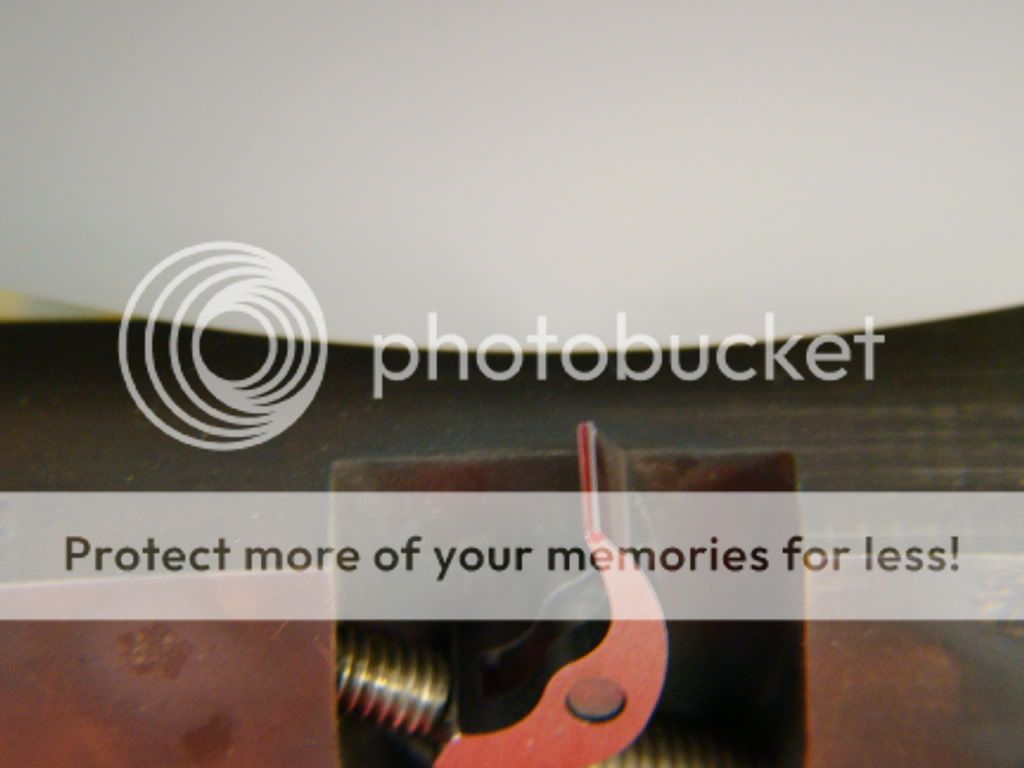

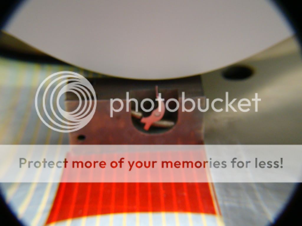

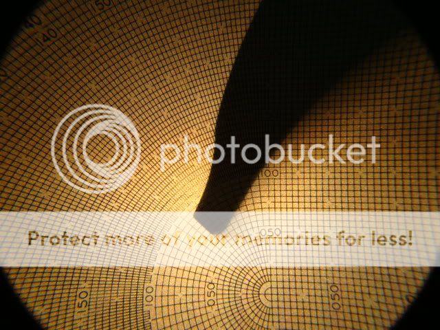

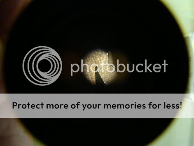

Placing the fixture block in the micro scope and or comparator allows one to focus on a direction if changes are needed,  otherwise it becomes a guesstimation ordeal that often ends in a short sear. I am a neutral engagement advocate when using angles, as shown in the scope picture..
Powers sear jig tips DSC00073
Grinding the primary angles...
Powers sear jig tips DSC02247Powers sear jig tips DSC02246
The red and green shim stock, allow shiftiing the primary face in an attempt to pick up equality on both hammer hooks
Powers sear jig tips Searangles004
Setting up to do the secondary cut
Checking for sear anglePowers sear jig tips DSC02847
Set up for hammer work
Powers sear jig tips DSC03962_zpsb6db1914
Hammer hooks being equalized.
Powers sear jig tips DSC03961_zps62c69feb
Hammer hooks being checked on the comparator
Powers sear jig tips DSC03960_zps1323126c
The ultimate sear fixture.. Perfect in ten minutes or less..
Powers sear jig tips DSC03934_zpsd8d09c7b
