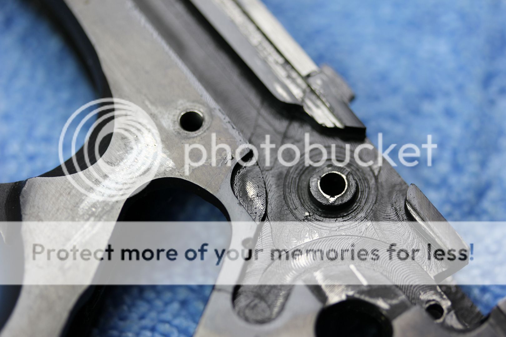

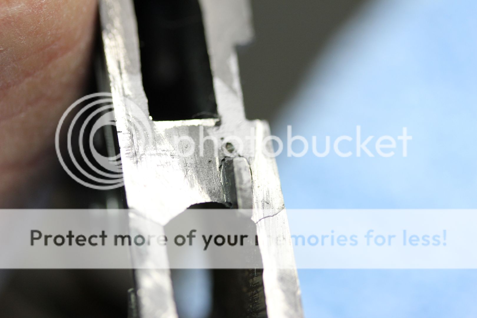

Post by Jerry Keefer 7/6/2016, 10:05 am
As you can see, the machining was crude and created many stress risers.. HS had very good barrels and their chambers were closer to target  grade than what's commonly available in mass production today..
HV Ammo in High Standard? IMG_1949_zps8q9zsxco
HV Ammo in High Standard? IMG_1948_zpspdatdmo6
HV Ammo in High Standard? IMG_1947_zps39dqjy70

I have seen several broken High Standard frames.  One worse than the one Jerry pictured.  Those with a known history all had HV ammo usage and weak recoil springs.  When in doubt, change the spring.  And never use HV ammo.  Period.
