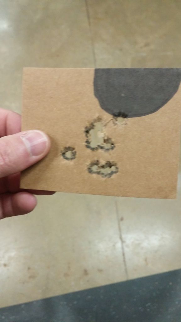

Post by Chris Miceli Sun Jul 31, 2016 9:37 pm
I had Jon rebarrel a new to me Wadgun.  Here is a 50 yard slow fire from Perry shot from my hand factory zero 185jhp. The BE smiths on the forum will get your gun very accurate.

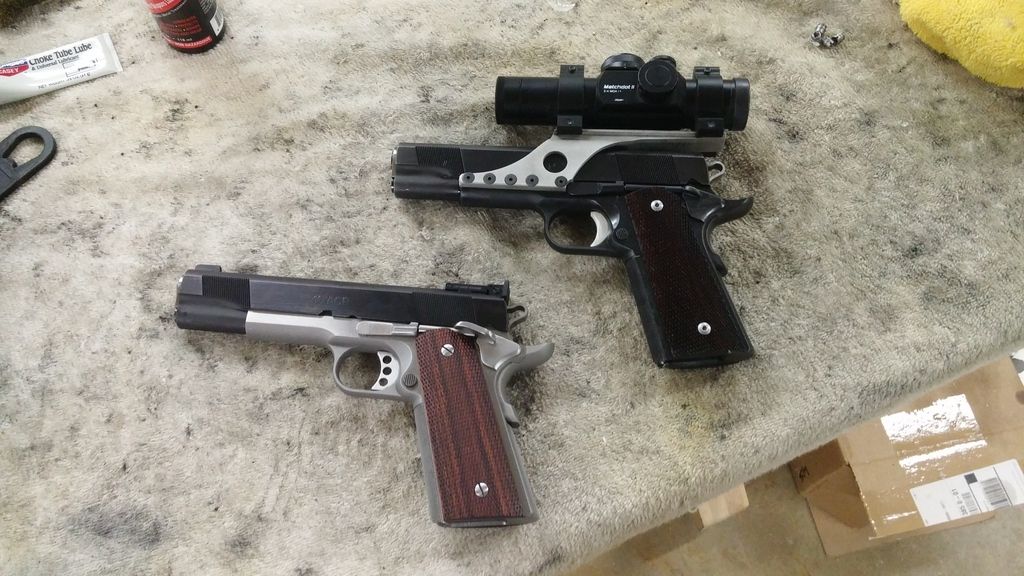

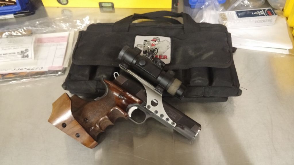

Post by zanemoseley Thu Aug 04, 2016 7:56 pm
Here's the new (to me) pistol with the upgraded RH grips. I'm going to let a shooting buddy try the grips and see if he wants them, they may be up for sale shortly.
Need pistol advice, fix up my Les Baer or buy used wad gun? 0803161718_zpsnptq3kso
Got the grips swapped back to original, both my Baer's side by side. Its gonna be like giving up a child selling the one Baer though lol.
Need pistol advice, fix up my Les Baer or buy used wad gun? 0803161809_zpsjhnihbjm
