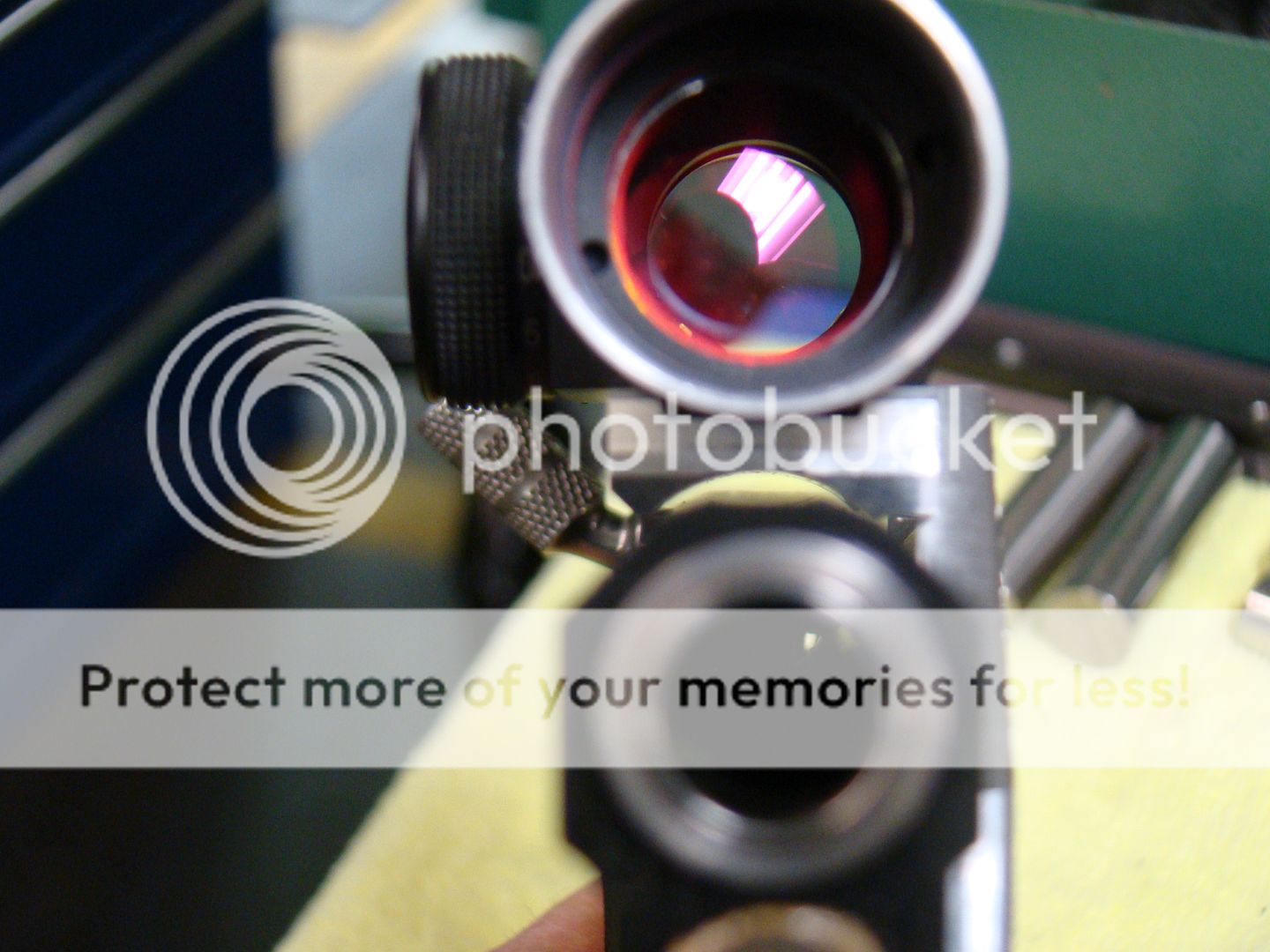

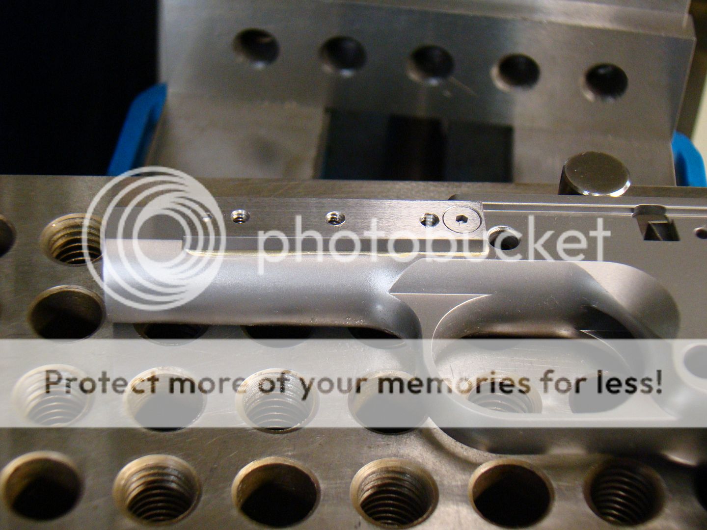

Saladman- Posts : 115
Join date : 2016-01-12
Re: Center Fire Gun Recommendation for Wife with Shoulder Issues
How did you mount that Aimpoint looks clever.
rich.tullo- Posts : 1916
Those are Keefer guns built for one if his customers. Which aimpoint you asking about ?rich.tullo wrote:How did you mount that Aimpoint looks clever.
Chris Miceli- Posts : 2715
Actually the one on the M52
i believe a pad is silver soldered and bolted to the frame, then the mount is added. David Sams sells a mount for the 1911.rich.tullo wrote:Actually the one on the M52
