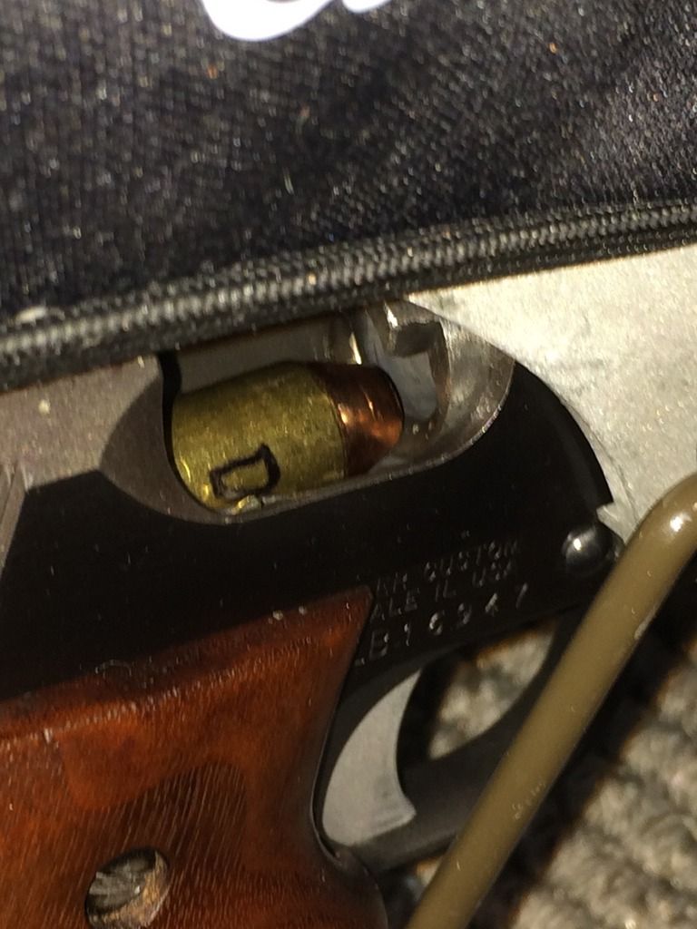

I too have had that problem with JHP in a rebarreled pistol.
1911 feeding problem 8CBFFFF3-220B-4E27-9BAA-9A9FC8A80560_zps48tg5nis
The things that worked for me were a combo of making the round longer (1.240"), swapping magazines to Tripp Research, cleaning and polishing the frame ramp and taking some material out of the barrel ramp. I'm not sure whether I took the material out in the way my pistolsmith suggested.  I'll be back at the range soon to confirm it is fixed when using 4 other mags.
I ordered an EGW high magazine catch, but have not needed to try it.  I have heard that fixed it for others.

Mag springs made no difference for me as the round naturally nose dives as it leaves the magazine's feed lips.

My feeding problem looks exactly like Aprillians photo.  I have some older Metalform Mags with rounded follower I will try.  The frame ramp is highly polished as is the barrel ramp. Transition area looks very good to me. What has me puzzled is that the 185 Semi wadcutters feed ok. I measured the rounds that hung up. 1.210 exactly. Yesterday I got four out of fifty.  I had my shooting buddies watch me to confirm it wasn't shooter induced. (3 x,s and a ten timed before malfunction}

Post by jglenn21 Sun Mar 26, 2017 11:51 am
had this very issue with my EIC 45. the EGW mag catch resolved it...
you can also bend the feed lips out on your mags to help point the round higher.
I use an AR magazine tool but it works fine on 1911 mags and doesn't scare them

Post by Aprilian Sun Mar 26, 2017 10:15 pm
I tested 180 rounds out of 5 different mags today and had ZERO jams.   I ran JHP, BNSWC and LSWC and all real fine.   I even got one really good target out of them all.
Good luck with your jams.
