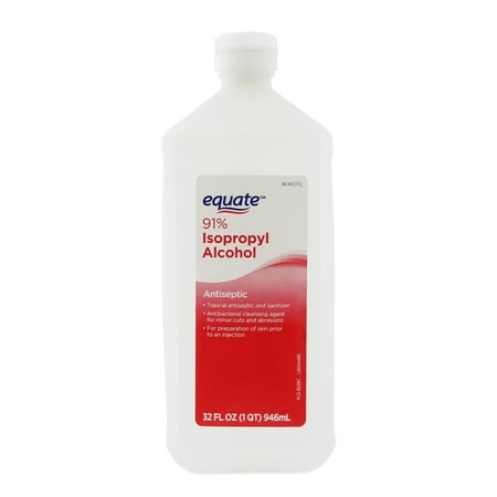

91% Isopropyl Alcohol (Isopropanol):
and MoPo 1.5 micron Molybnemum disulfide powder (via Ebay) - other high purity MoS2 powders will work:
I mix 1/3 by volume MoS2 with 2/3 by volume 91% Isopropyl alcohol - shake well. It dries quickly, adheres well, and has some penetrating properties. Other concentrations (1/4 by volume of MoS2 with 3/4 91% Iso) may work better for different uses. The main bit of information from all this is that the 91% Iso alcohol seems to work much better than other solvents I've used, such as Naptha (lighter fluid) or mineral spirits (paint thinner) to keep the MoS2 in suspension and leave no residue.
