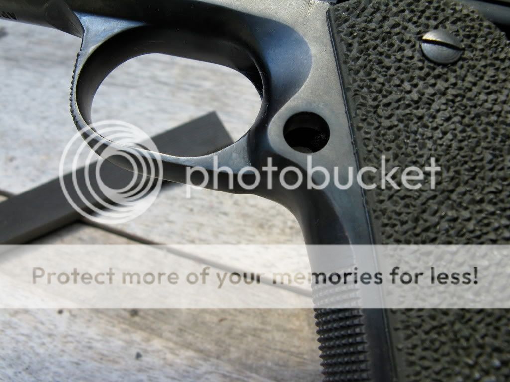

I've checkered four of my guns. For the first two, I used a 30 lpi checkering file. That drove my eyes crazy. For the last two I went to 20 lpi. It was a lot easier on my eyes.
Here is a pic of the tools I use to checker. I can't remember who makes the checkering jig, but I think it was from Al Marvel. It doesn't look like the Marvel jig available today from Midway and Brownell's. The file that looks like it has hooks on the end really works well for removing metal after you've got the lines laid out with the checkering file. You can put pressure right where you want it by pressing down in the curve. I don't remember what you call that type of file.
The rounded object is a 10X magnifying loupe that was left over from my days as a photo editor. I was going to buy a magnifier you can wear on your head, but this works out well. Just place it on the frontstrap and it is automatically in focus.
[img][/img]
This is a Rock Island Armory frame from Armscorp. The metal is softer than a Springfield or Colt, so it's actually a little easier to checker. It is a dedicated frame for my Marvel Unit 1. The points on the checkering are not that sharp and not that deep because I didn't want to chew up my hand.
[img][/img]
I also like the highest hold possible, so I undercut the trigger guard a little. I use a sanding drum and a Dremel tool. I would have ground away a little more material, but I was getting tired. I also relieve this area so it is lower than the checkering on the frontstrap.
[img][/img]
Here is a Springfield Armory frame that I didn't finish. I was getting tired so I just stopped working. I didn't need it for anything. I'll finish it later.
[img][/img]
Take your time. Don't over do it. Your fingers will tell you when it's time to rest. It usually takes me between 3 and 5 hours to complete a job. I usually work no longer than an hour a day. I can work faster, but then it is no fun at all. Let the files do the work. If they stop cutting, don't exert more force. Chances are the teeth are clogged up and you need to clean them with a file card. Good luck!
