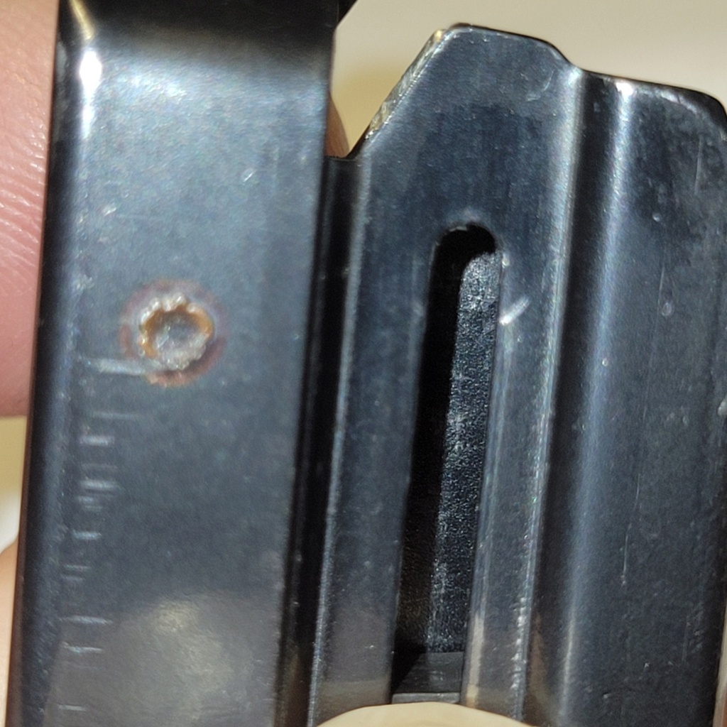

Post by BruceV Thu Apr 27, 2023 11:17 pm
I had the same issue 4th round didn't eject and 5th round didn't chamber, but only one of my magazines.
Because it was only one magazine I was pretty sure it was not the extractor or extractor spring, recoil spring, o-rings or firing pin and spring.  But because I had a pretty good round count on the gun I replaced all of those parts.
Still that one magazine kept on failing.  I looked at that magazine compared to all the others and what I noticed was at the very front of the ejector, the tip was getting mushroomed and causing a little lip on the front inside of the ejector.
Also the slot in the magazine that the button pin that holds the follower/elevator in place at the very top where the pin stops, the slot was every so slightly indented.  I could feel the pin hang up a little bit.
Now beats me if any of that would cause the problem, but I sanded the inside of the ejector smooth and the top area of the slot smooth.
Ever since then the magazine has worked perfectly.
I can't say that was the problem but it works now.
The first 3 pics show what it looked liked, the last pic after I sanded the areas.

I have a brand new SP with 400 rounds thru it. Mine is doing the same thing depicted in the photo's. Would not think it could be a fireing pin or extractor or springs. As stated! This is a brand new gun. I have only used one of my three new magazines. I'm going to use a new magazine this weekend and see what happens. This using CCI-SV. I would switch to eley target or club. But I have 4 cases of CCI. Hope it isn't the CCI causing this issue. Will report back next week if the other magazines do the same thing.
