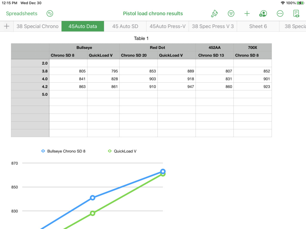

Here is a screenshot of some data comparing 4 powders Red Dot, 700X, Bullseye, and 452AA.  The gun used was a 10 inch Contender.  Each was run in Quickload to get an idea on velocity differential between a 10 inch and a 5 inch barrel as well as a guesstimate of pressure.  The differential in velocity between 10 and 5 inch barrels was about 75 fps.  The pressures guesstimate for red dot was 13000 psi vs 9000 for bullseye.  So Red Dot is way hotter.
Loading 45acp with Red Dot 13adde10

Looking at the chart they are like the powder charts I looked at in my Lee loading manual. What I don't see is a entry for 200 plated or 230 plated using Red Dot powder. Like for FMJ red dot says 5gn. The only powder they show for the 230 plated is Accurate #7,#5 and #2.

I forgot to mention those were with cast 200 grain SWC and results will be nearly identical with plated.  I have no data with 230s, but I would start at the starting load of 700X and go from there.  Just be cautioned, that Quickload is indicating that Red Dot is a bit touchy.  Seat the bullets .030 deeper and pressures go way up, add .2 grains to a just below max charge and you’re over max and into +P range.  So I keep my loads well down onto the middle range of pressures.  I was born with 10 fingers and I want to keep them, thanks.
