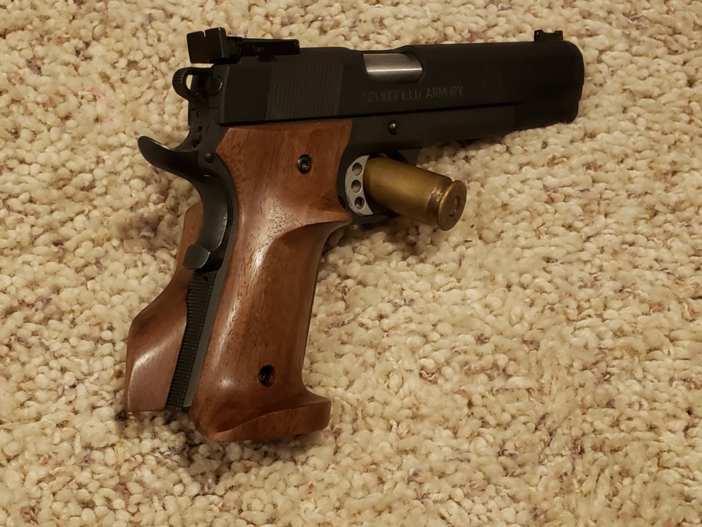

I made some grips from walnut for my SW Victory 22. I used them for a while and kept whittling them down over time whenever I felt an uncomfortable spot. Applied some grip tape and they feel good.
For my 1911 style pistols, I created some similar contoured grips and found, much like other posters here, the stock slab grips are pretty good unmodified. Even though they look about as ergonomic as bricks. I just add some grip tape to the front strap if it's too smooth. I do modify the left side to give my thumb a little shelf, because I like to have downward thumb pressure. I'm still unconvinced what size it should be.
