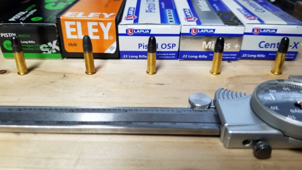

(Sample size 1)
SK Pistol Match, dry case noticably oily bullet, length 0.979"
Eley Club, very lightly waxed, .984"
Lapua Pistol OSP, dry case noticably oily bullet, .972"
Lapua Midas +, dry case lightly oiled bullet, .974"
Lapua Center-X, dry case bullet heavily oiled/waxed, .972"
Those three Lapuas appear to use the same bullet. The SK pistol match appears identical until we get to the very tip, where the SK is smoothly rounded and the Lapuas taper in at an angle.
So yes, these sampled Lapuas have similar oiling/waxing (hard to tell quite which it is) to the SK pistol match. My understanding is that they're made by the same firm, possibly in the same facility.
At the beginning of Covid Midway was selling Lapua IIRC for ~60% off and so I bought quite a bit ...
I plan to chrono these from my Pardini. The SK and Eley have markedly different levels of felt recoil (SK soft); curious to see how much variance is in the Lapua both within a box and between lines. I've been told the Midas+ is a rifle round. I saw two finalists were shooting OSP in the "2020" Olympics Mens rapidfire 25m, for whatever that's worth.
