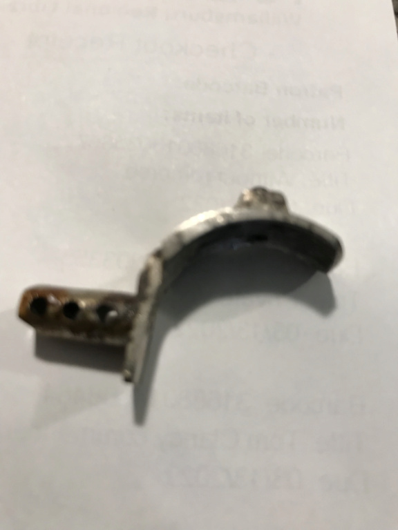

Thanks for the info Jack and Nopro.  I've done a more detailed strip and removed there trigger.  We'll see how it works after a thorough cleanup and reassembly.  I think that the problem is/was apparent in the photo of the trigger below.  Oddly, despite the rust on the trigger and a little on the trigger pin, there was no rust on the frame in that area.  Sorry for the fuzzy pic.

Post by Jack H 3/22/2022, 6:52 am
Original HS triggers are can look like they are corroded.  But I think it really is a flaking of the material from how they are made.  There is a name for it I can't recall.

Post by Wobbley 3/22/2022, 10:47 am
Exfoliation corrosion.  Metal and post-treatment specific.  However, steels tend to not exfoliate just rusting away.
