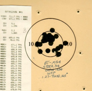

The MG4 barrels shoot very well. I tested one a while back.
Bullet fit is the key. You need a 0.314" HBWC bullet of GOOD quality.
H&N were the best; although, no longer available in the USA nor Canada.
Bumping up the Speer 98 HBWC to 0.314" is the second best. Here you need to invest in a bullet swage.
![32 SWL long line loads Mg4_0020](https://i.servimg.com/u/f41/19/60/91/34/mg4_0020.jpg)
![32 SWL long line loads Mg4_0019](https://i.servimg.com/u/f41/19/60/91/34/mg4_0019.jpg)
![32 SWL long line loads Mg4_0021](https://i.servimg.com/u/f41/19/60/91/34/mg4_0021.jpg)
![32 SWL long line loads Mg4_0023](https://i.servimg.com/u/f41/19/60/91/34/mg4_0023.jpg)
![32 SWL long line loads Mg4_0022](https://i.servimg.com/u/f41/19/60/91/34/mg4_0022.jpg)
