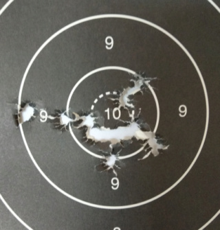

I sometimes use a 9mm CZ for ISSF. The load is 2.7gr WST with a 135gr LRN. It shoots very soft, and it is plenty accurate at the short ISSF distance. The target below is from a recent match, during the slow fire segment (the indoor range is 20 yards). I blame myself for that 9. I'd say a 9mm 1911 is not a bad idea at all!

I will post this everytime I read 32swl are difficult to load for. First load tried... 1.7 bullseye, cast and coated bullet sized to .315. Walther gsp.50 yard rr targer.Centerfire pistol for NRA precision and ISSF Mms_im13

10sandxs wrote:I will post this everytime I read 32swl are difficult to load for. First load tried... 1.7 bullseye, cast and coated bullet sized to .315. Walther gsp.50 yard rr targer.
Which implies that you cast your own bullets to a non-standard size and then coat them. Even without any other considerations that, for me, puts it firmly in the context of "difficult".
Even with checking each load to exactly 1.4g N310 (so, given the GEM 250 tolerance that's between 1.38 and 1.42g), measuring the COAL to .963 +/- .002 and with the crimp being identical to within the limits of measurement - using Lapua .314 98g bullets I can't get my MG4 to group to less than 3 inches and the 6th shot increased the best one to about 5 inches.  At 25 yds it's one ragged hole. Certainly smaller than the X ring.
So no - they aren't specifically hard to load for - but finding the correct component mixture for a particular gun / barrel to create that load can be a real adventure.
That performance is slightly better than I can get from either Lapua or MagTech factory ammo.
For info the barrel slugs to .3138 - .3139 (two slugs - two measurements)
Given that I have neither the time, space, resources or even inclination to cast my own bullets I seem to be at an impasse. I have thought of swaging bullets for 50yd loads - but that's a whole lot of capital expenditure, never mind the ongoing effort, just to get one gun to operate at the long line. It will, of course, be a great gun for the indoor winter league but that wasn't exactly the intended use case.
Of course I could get Dave to make me a new barrel. Hmmm ....

I think your thinking too hard on this one. If your measuring charges to 0.01 grain, your process is already more detailed than mine. I do use the arrendondo micrometer powder bar on my 750 and the long expander from photoescape, but that's pretty standard for those loading the 32.
For the bullets, I use a standard Accurate 31-088W mold with soft lead (reclaimed pellets and shot) coated with hitek and sized to .315 with a noe push through sizing die. All of which, you can buy off the shelf so to speak.
A Lee lead pot, either a dipper or bottom pour will do the job. To be honest, I didn't even cast what i consider "good" bullets as the 32 is a fun distraction for me, not something I'm going to shoot a lot. My kid likes it so I keep making ammo for it.
Coating isnt that hard once you get the hang of it, and a cheap toster oven is all you need. Buy a few 2 quart plastic paint buckets from hardware store and you've got your coating containers...
It's really not that hard especially when compaired to swaging (where you have to cast cores anyway)... fit a bullet to the barrel and your 90% there...  btw, .314 shot REALLY bad at 50.
