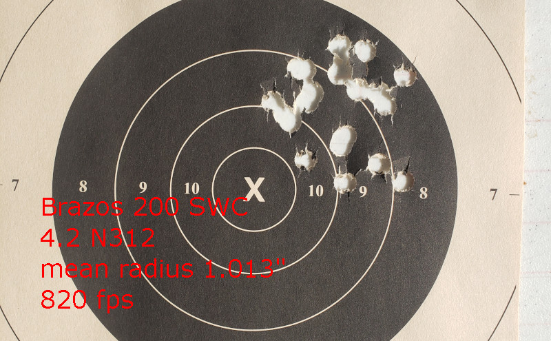

Then some Brazos 200 gr SWCs (3.1" extreme spread) -
![Load Workup Advice Res-sw11](https://i.servimg.com/u/f76/19/96/73/94/res-sw11.jpg)

Can't say I'm delighted with any of these, but the Brazos 180s appear best. They had the best mean radii of all the loads, though one of the groups had some vertical stringing for some reason. They tell me there is an art to getting groups out of a RR, but I think I was fairly consistent in the reset and trigger pulls.
Do any of you think it's worth messing with seating depth? I was going to try that with the Brazos 180s and see if things get any tighter.
Other suggestions?

You might try a tighter crimp (.463"-.465") with the 180 or 200 Bazos before noodling with OAL.

Try some traditional ball powder like WST or BE and try a tighter crimp as mentioned above. I like WST and .463" crimp with lead. Extruded powders are typically slower burners for rifles but not familiar with your powder.
