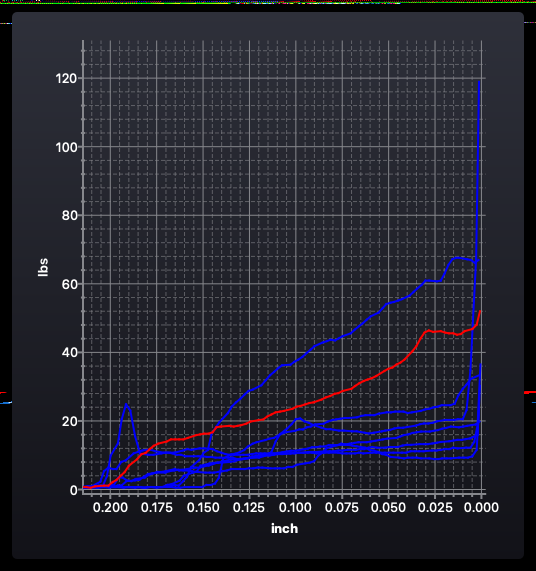

Hello,
I have been working on using modern measuring techniques with statistical analysis to answer a few questions about the importance (or non-importance) of what brass life may play in ammunition accuracy. I had some cracked brass run through the test barrel. The cases were cracked to varying degrees and all definitely would not be recommended for use in any reloading or further reloading. However, I thought it might prove interesting to see what results we would get on a target, and whether or not cracked brass would be wildly inaccurate. It wasn't.
Don't misunderstand- I'm not advocating the use of cracked brass, but rather highlighting that should you run into a case during your shooting, you may very well not be able to attribute that case to a poor result on the target. Since it is impossible to predict when brass will crack other than the likely hood going up with additional firings on a case, it is difficult to really say more than what I have here regarding case failures and accuracy issues. If anyone has a good idea about how we could potentially induce a cracked case to fail during shooting- I'm all ears.
Load Details:
4.12 VV N310
CCI LPP
Misc brands of brass, all USA make
Zero 185 JHP
Seating pressures as measured by AMP Press:
Finally, the chrono data from the labradar:
Stats - Average 735.15 fps
Stats - Highest 777.38 fps
Stats - Lowest 637.75 fps
Stats - Ext. Spread 139.63 fps
Stats - Std. Dev 44.46 fps
It would appear that seating pressure may not matter for accuracy; however, more work needs to be done to be able to resolve that issue completely.
Enjoy,
Chase

Interesting. I wonder if the low shots were with brass that had cracks extending below the bullet base, allowing for some pressure blow-by, and therefore lower velocities.
Dcforman- Posts : 774
Age : 41
Re: Cracked Brass Test Target
Great question- I don't know. Some were "minor" cracks, and others were more severe. I should be getting the brass back, so I'll measure them and update this thread with findings.

On the other side of the brass life, what does the seating force (as the graph that you posted reads it is force not pressure which would have been reported as psi not that it matters too much, just wanted to note that it is different) in new factory brass look like?

Ed Hall wrote:In my experience with some cracked (from the factory) Federal Match ammo many years ago, the variance that was observed came from the bullet setting back in the case during either recoil within the mag or during the loading of the round into the chamber. When I tested in a gun at 50 yards, carefully loading each round individually, I got groups around 1.75 inches CTC.
Ed- I got a note back to me about these cases after testing, it is as follows:
"The test with the split cases. Almost all cartridges did not chamber freely. None had to be forced into the chamber; but, thumb pressure was adequate to seat the cartridge fully."
Just mention it as another data point for folks. There wouldn't have been any setback from recoil (these were not in a magazine, but rather his barrel testing fixture) but it is possible that since these cases couldn't take a crimp that some, however minor, force to seat them could have influenced the results.
It's a good call out- thanks!
-Chase
