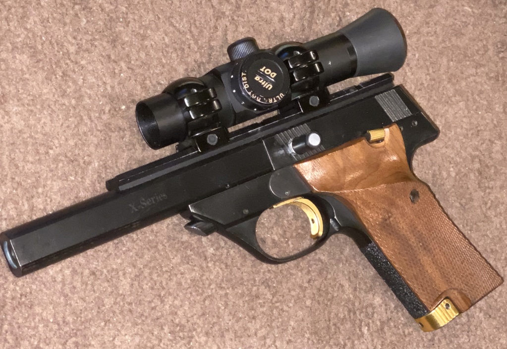

The 103 was next to impossible to pull my slide back, and ditto for my Victor and X-Series.
Call Alan Aronstein, the High Standard distributor, and ask him to sell you the small aluminum "post" that goes into the slide. He put one on my X-Series, and now it's easy to do.
You (or he) will drill and tap the slide, and screw in the aluminum post.
You can see it in this photo, wrapped in black tape to make it a little. larger:
Suggestion - send him your slide, and let his tech people mount it for you - or take to your gunsmith.

Before I sold it, my own 103 had a rail and red dot sight on top. If I wanted to pull the slide back, and cock the hammer, for me it was impossible
If you've removed the rear sight from the dovetail, and mounted a red dot sight, here's what I did. I found a part (not sure what) that dropped into the dovetail, but extended to the rear a few inches. To rack the slide, I dropped this part into the dovetail,, pulled back on this thing I was using, and it made it easy to rack the slide. I would take a picture, but when I sold that gun, I included my home-made "slide racker".
Anything that allows you to pull on your tool, while it is dropped into the dovetail, will work. Looked silly, but it worked for me for a few years. You could even make your own with a piece of wire thin enough to go into the dovetail, tied together behind the gun, as you pull on the wire from behind the gun.
You only need it when the slide is forward, and the hammer is not cocked.
If that dovetail is not accessible, this idea won't work.....

I had a similar problem with my HS Trophy. I had a full size Ultradot Matchdot 2 on it that worked great but left very little room to grab the slide. Dropping the magazine helped a little but, the best thing I did was get a much smaller red dot sight and moved it more forward on the rail. That left a lot more room to grab the front serations on the slide. I couldn't bring myself to drill into a Hamden High Standard. Try an Aimpoint clone or an open red dot. Try it before you modify the gun it may be enough.
Nopro- Posts : 50
Join date : 2020-05-08
Re: High standard 103 very difficult to pull back.
That's sort of what I did - I removed my Matchdot II, and mounted a Vortex Venom, all the way to the rear.Nopro wrote:I had a similar problem with my HS Trophy. I had a full size Ultradot Matchdot 2 on it that worked great but left very little room to grab the slide. ......the best thing I did was get a much smaller red dot sight and moved it more forward on the rail. That left a lot more room to grab the front serations on the slide. I couldn't bring myself to drill into a Hamden High Standard......
My right hand can grasp the serrations on the rear of the side, and pull.
My left hand can grab the serrations on the front of the slide, and push.
Once the slide moves, just a short distance, the rest is easy.
Roddy Toyota, who sold me the gun, said it was a "shooter", not a "collector" gun.
I haven't yet got up the will power to mount the "pin" in the slide, but if I want to enjoy shooting this gun, I should.
(For me, and my eyes, the dot looks "rounder" the further back the sight is.)
