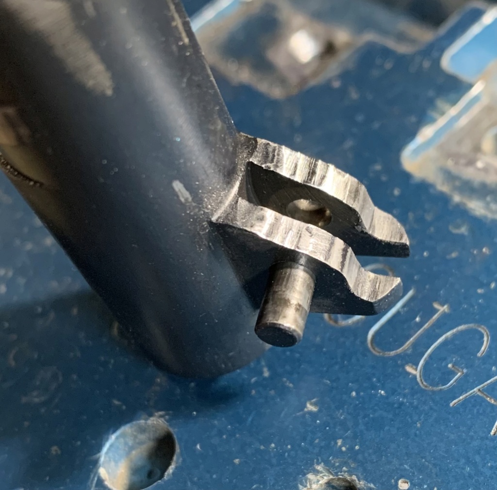

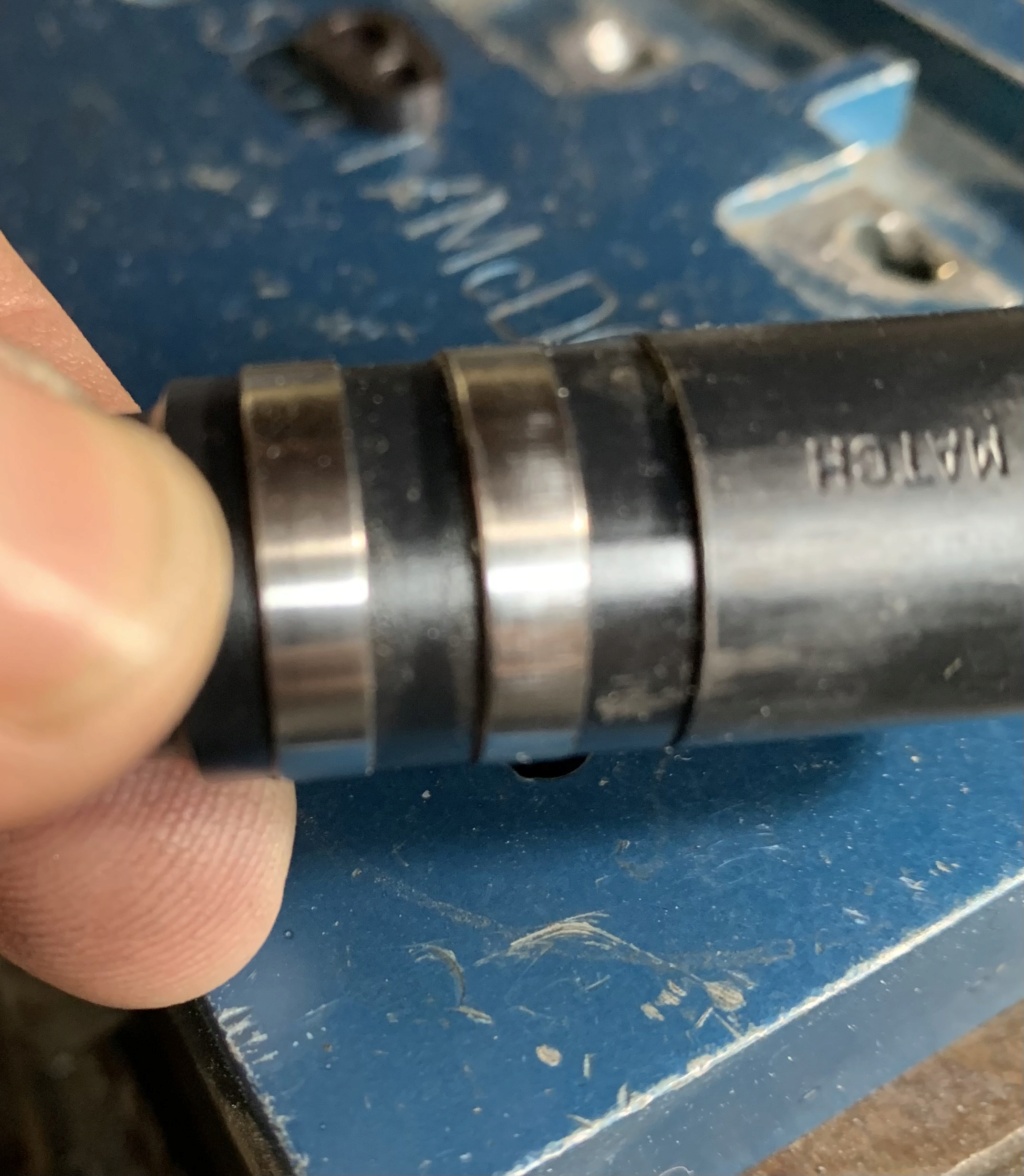

Here’s a photo of the bottom lugs on a Baer 45 acp barrel. Crude marks on the front of the lugs do not affect accuracy, but craftsmanship is lacking. Barrel link was too short and slide stop was battering the radius on the bottom lugs. That does affect accuracy; it cause erratic cycling/chambering. Typically vertical grouping.
Upper barrel lug not fit. Slide contact at extreme 3 and 9 o’clock. Not fitting upper lugs leaves minimal lug engagement which equates to more felt recoil because barrel comes out of battery sooner. Will shoot good from RR like this but be unforgiving to shoot from hand.
I dressed up the lugs and installed a proper length barrel link.

Wow, I don't know a lot about how a 1911 should be fitted but that looks awful.

My Baer Premier II had similar problems as well as a slide stop tapered .005" from edge-to-edge....I guess that's one way to fit a barrel.
Hardest recoiling .45 I've ever shot.....by a lot.

That's just sad.
And they're not giving those away!

What do the after pictures look like?

That is seriously ugly...

I think I could have done a better job with an Ax! That is a very very very bad job! That's why I will not recommend LB to anyone!
