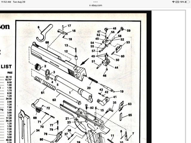

Post by RodJ Tue Aug 29, 2023 1:59 pm
Once you unscrew the bushing, underneath it is a plate, Part 3 in the diagram.  It holds the plunger, Part 4, and it’s spring, Part 5, in the hole in the slide nose. (plunger has a shoulder - the thin “head” pops up through the plate).  Remove the plate and it should all come out. Might need tweezers.  I’ll confirm when I get to my pistol.
Wrong-o on my part.  Hmmmm…
Barrel Bushing Plunger Removal S&W 52 Img_0013

Post by RodJ Tue Aug 29, 2023 2:33 pm
Okey doke.  99% certain that the plunger is staked in.  On the muzzle, there’s a small stake mark, kind of semi circular, from about the 6 to 9 o’clock position. When I look from the side, the shoulder of the plunger is depressed maybe 0.005” or so below the muzzle surface.
Given that the plunger has an important role, I think it shouldn’t be staked in place.  I’d want to keep that thing clean and moving freely.
Must have been someone that almost put out an eye, and OSHA or the CPSC demanded the staking.  Rolling Eyes
Smarter people will have a thought as to how to “unstake” it.  Maybe a mini lathe and a mini / nano sized cutter.
