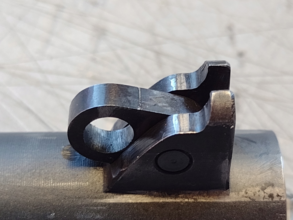

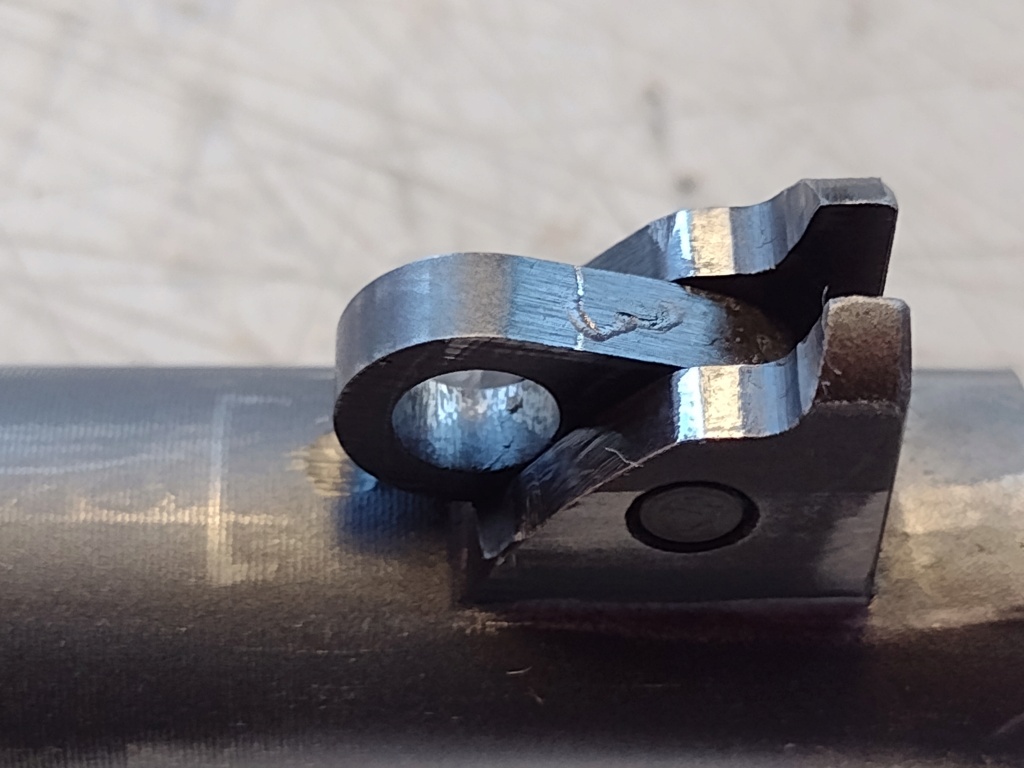

Unfortunately there are people and gunsmiths who have no business fitting a NM barrel. And to make matters worse there are those who charge you money to do this
This barrel was not contacting/bearing on the slide stop pin. Meaning barrel moved freely vertically in battery.
To make matters worse there is no flat bearing surface. If barrel had made contact with the slide stop pin it would've unlocked immediately. My opinion you get more felt recoil because slide is not being slowed down during unlocking process and no real repeatable accuracy.
A stock RO barrel is fit better than this Colt NM barrel.
So when you think about labor prices of fitting a barrel, remember what you're paying for.

That's horrible. Wonder how long that could have been shot till that ear snapped off.

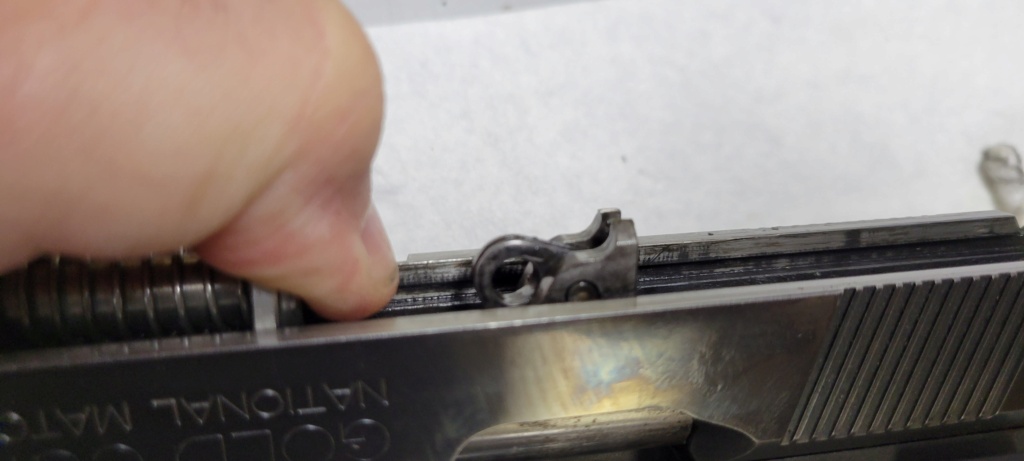

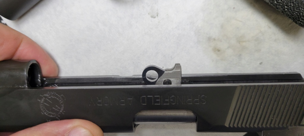

That's a good pic for two reasons. First it shows original barrel fit. Then you can see the micro laser welded surface refit correctly.
This is a Colt 45 ACP Kit Gun Barrel from a 1970 Kit Gun built by Shockey. I have another kit gun by Giles that is worse.
Slide travels linearly on frame rails. The bottom barrel lugs should be parallel to frame/slide rails. 99% of old school 1911"s and poorly fit guns are not parallel. So you get a nice RR test target, but they are unforgiving as he'll from hand. I have recently acquired two really nicely built older Clark's. I have to work pretty hard to hold 10 ring at 25 yds. They recoil harsher and unlock quickly from battery making it harder to shoot them well. Shooting the welded up barrel pistol I'm holding X. It really makes that much difference.
Sadly it's common to be disillusioned that owning an older Clark, Giles, etc is a great match pistol, but in reality it's ready to be rebarreled.

Jon Eulette wrote:That's a good pic for two reasons. First it shows original barrel fit. Then you can see the micro laser welded surface refit correctly.
