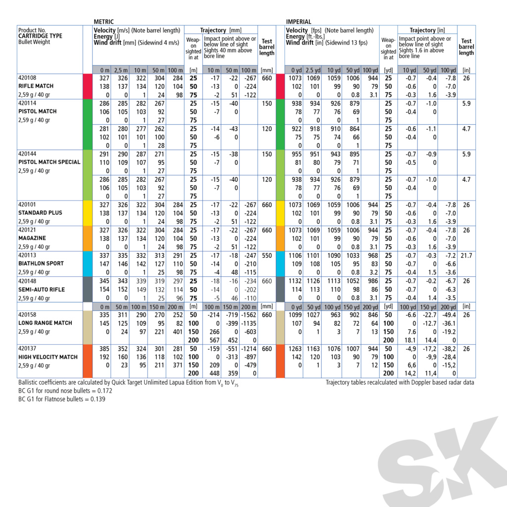

This chart dips from S-K. The barrel lengths are indicated. Pistol loads show a velocity of 950 fps or so. Rifle loads ar just under 1100. But I’d be surprised if they were loaded to different recipes.
Froneck wrote:Group size is good to know but what was the twist rate of the barrels? Being I'm using the barrel in a .22 conversion 5" barrel length length is being used.
What about ammo velocity, anyone know how the listed velocity is measured as to length of barrel used? Do all the velocities listed on the ammo box developed from the same barrel length? I did find a chart for SK ammo, velocity is from 26" barrel for rifle ammo and 4.7" and 5.9" barrels for pistol ammo. But is the velocity in the chart the same as what is listed on the box? (https://sk-ammunition.com/rimfire/ballistic-data/)

Wobbley; That is the same chart I posted a link to. Are you saying all the Ammo is the same and they tested in in different barrel lengths? If so why is there different velocities for same barrel length? Granted a shorter pistol barrel will have a lower velocity than a long barrel with the same ammo.
Chiz: Some time ago I purchased a Douglas barrel to re-barrel a friend High Standard. Was winter and cold out side so I tested it in our clubs indoor range, it shot terrible at 50 feet! No matter what I tried I could not get a good group. Yeah the group was small about 1-1/2" but that would get worse at 50 yards! I finally called a friend Floyd Aikman and explained all I did. He asked if I told Douglas I was making a pistol barrel, I replied yes! He said NEVER tell the barrel maker your using the barrel in a pistol! So later I called Douglas and said I'm making a .22 bench rest rifle and the guy insists on a Douglas barrel, thinks they are the best made! I got the barrel, grouped one hole at 50', took it out side and at 25 yards it still grouped one hole, at 50 yards it was little bigger than dime size! Ever since then I never purchased "pistol" barrels though I never did a .22 rifle barrel! So buying barrel blanks to experiment from the top makers will get quite expensive! Not to mention the time it takes to machine the barrel from a blank!

Only way to find out, really, is to shoot both “types” of ammo in the same barrel. But I also know that both SAAMI and CIP specify the same barrels for velocity and pressure testing. So I’m inferring that the ammo is loaded the same whether for pistol or rifle. And looking at it from a manufacturing standpoint why would it be different? Different lube? Sure. Different final form on the bullet? Sure. But powder charge? I’m not sure that gets you much.
