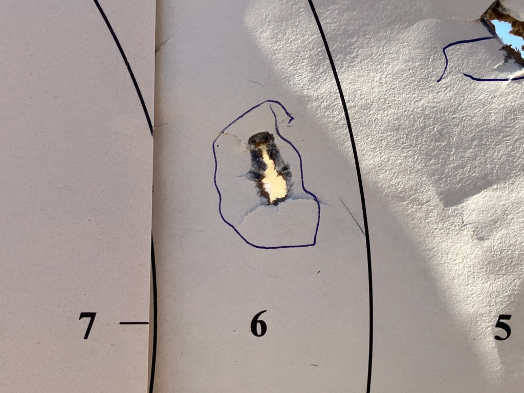

Post by mbmshooter Tue Nov 07, 2023 3:36 pm
Newbie 1911 Questions Img_1510
Newbie 1911 Questions Img_1511
Newbie 1911 Questions Img_1512
james r chapman wrote:Find a Springfield Armory Range Officer.
Lightly used would be great.
Or,
Contact Dave Salyer in S. Carolina
We just had our (probably) last outdoor league match of the year yesterday.  One of the shooters was having VERY strange oblong hits on his target that were only half the width of a .45 bullet.  I was puzzled and suggested he shoot a few on my loads (185gr Star LSWCHP over 4..0gr of Bullseye).  He wanted me to shoot them which I did along with 5 of his load.
3 of the 5 rounds I shot of his loads also had these strange oblong impacts on the target while all of my rounds were perfectly rounds hits.  I suggested he had a BULLET problem and not a pistol problem.  He is using Missouri bullets.
Sorry for the long posting but the pistol he has is a Springfield RO.  This was the first time I actually got to shoot one and was very pleased with the feel, trigger and accuracy.
If I were starting out again and had a limited budget, I would definitely consider the Springfield RO.  I agree with James' suggestion to find a lightly used one.
Mike
Last edited by mbmshooter on Wed Nov 08, 2023 11:57 am; edited 1 time in total (Reason for editing : I've finally figured out how to post some photos. I am hoping to receive some reasonable, analytical responses on why these Missouri Bullet Co. bullets would print such odd, oblong holes.)
