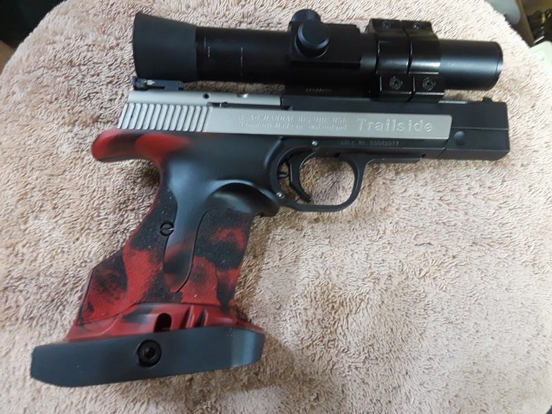

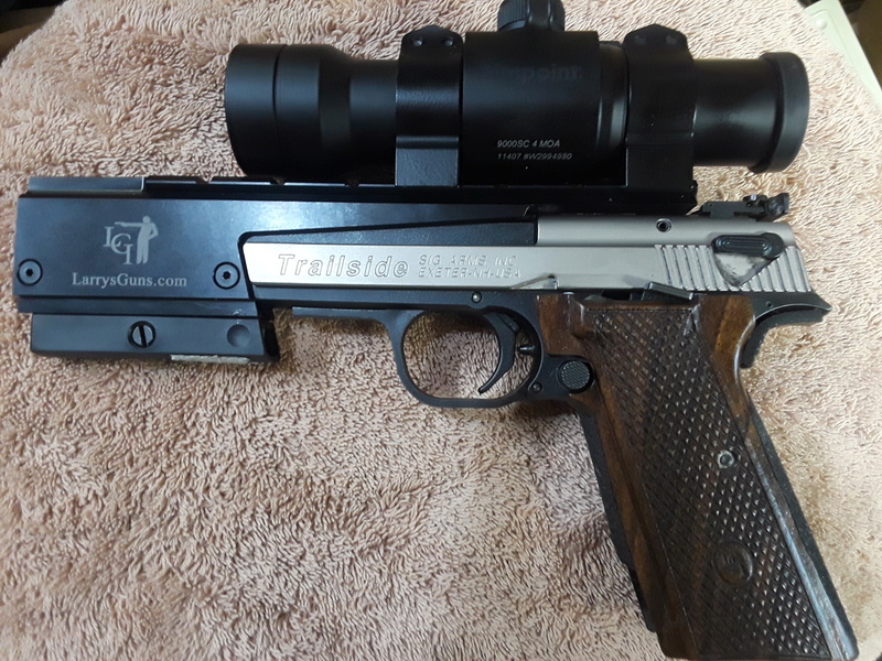

1st one is a 6" trailside with a Larrys mount , Aimpoint 9000sc, Laryys 1911 grips
2nd is my wife's 4.5 " with a 1"UD. Xesse grips.
the barrels are cut for a 22 Tip Off mount. Leupold and Warne make good ones.
