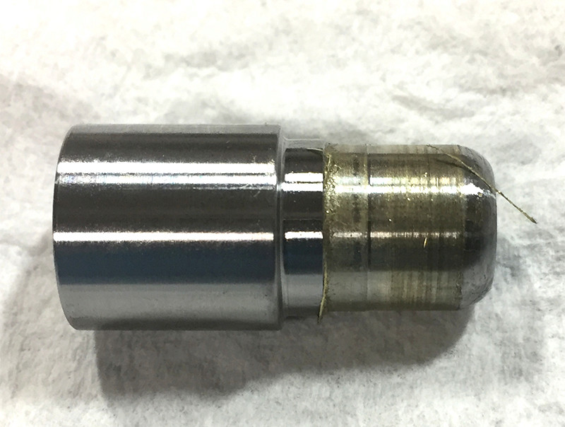

I was following the thread on 'Correct diameter expander for 45 acp lead'. A lot of good advice in that thread so I thought I would give it a try.
I reload Zero swaged 185 grain SWC-HP. I purchased the NOE 456/452 expander. I use a Dillon 550B. I use Starline brass.
I am able to set it up so that I can push, with very little effort, most of the bullet into the case, as can be seen in the top photo. However, regardless if I use new brass, many times fired brass, brass with little carbon buildup on the inside, brass with carbon buildup on the inside, make the expansion shallower; the plug is shredding the brass, as seen in the bottom photo. I tried lubricating the inside of the brass, no difference. I hear the shredding as soon as the plug enters the case. The buildup on the plug was from expanding less than 25 cases.
Any advice on solving this issue will be greatly appreciated. Thank you.

IMO;
1) you are going in too far into the case, I set mine to only go half way up the step
2) you appear not to be lubing your cases enough, There is a lot of brass embedded in the plug for just 25 pulls. I clean my plug regularly with 2000 grit to remove the surface brass before lubing it with Lee case lube (in the tube).
I'd look at your case mouths, if they have a burr on them you might want to try a light chamfer on 25, clean the insert and try again. You could also try a few cases that are not resized to see if the same thing happens.
Tooling gets old, your insert seems to be rougher than my 3. You can try polishing down the high points. If it made chatter from day one, contact Noe and check with them for ideas.

The photo of the expander fouled with brass suggests you are either using brand new brass or your fired cases are too clean.
The brass is welding itself to the expander plug. Try putting the plug in a hand drill and cleaning it with a piece of fine steel wool or ScotchBrite.
To prevent this from happening, spray some case lube on the brass to offer some lubrication.

I have a Steve Bathje expanding die in my 650. Had the same problem as you with brass shaving and brass embedded in the Bathje expander plug. As I recieved it the expander plug was a bit rough so I just polished the expander plug and I give a quick squirt of Hornady One Shot to cases as they are standing up-------problem solved!
I can see from your picture that your expander plug is a bit on the rough side also with tooling marks. If you polish them out I'm betting your problems go away. I used some Tripoli on a rag wheel mounted on a bench lathe. You could do the same with a hand drill and felt or rag wheel.

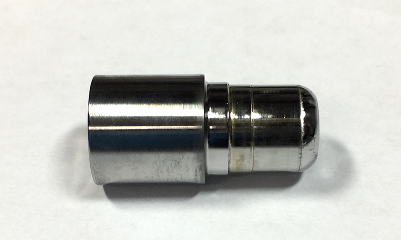

And the gold star goes to those who recommended polishing the plug. While shortening the cleaning time did help, polishing the plug made the biggest improvement. The photo of the plug with the original post was after reloading less than 25 cases. The photo below is after reloading well over 100 cases. Changing how I lubricate the brass or what I lubricate with did not help that much. And in my situation, deburring did not help that much either.
I had never polished metal before so I consulted the experts (YouTube) and purchased a polishing compound sample set that included a compound specifically for stainless steel. I then purchased polishing pads for my Dremel. It took me two tries to get it right. The second time I used the tip of a toothpick and ran it over the surface of the plug to find the 'rough' spots because I could not feel them with my finger.
Again, thanks to all who offered suggestions.
