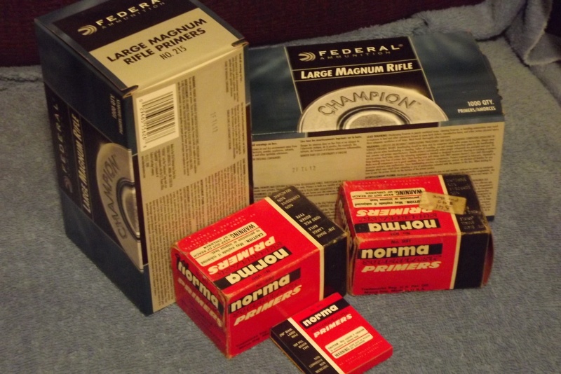

Post by Jack H Sun Apr 20, 2014 11:04 pm
I have not seen a Federal primer for rifle or pistol in ages.  I was raised on Federal 210 and 215 in my rifle days.

Post by LenV Sun Apr 20, 2014 11:58 pm
I have a couple bricks of 215 in my safe....sitting beside my norma primers Smile
Posts : 4676
38cal HBWC bullets manufacturers? Empty Re: 38cal HBWC bullets manufacturers?
Post by LenV Mon Apr 21, 2014 1:44 am
Should donate to a museum.The Norma that is.38cal HBWC bullets manufacturers? Rare_010
