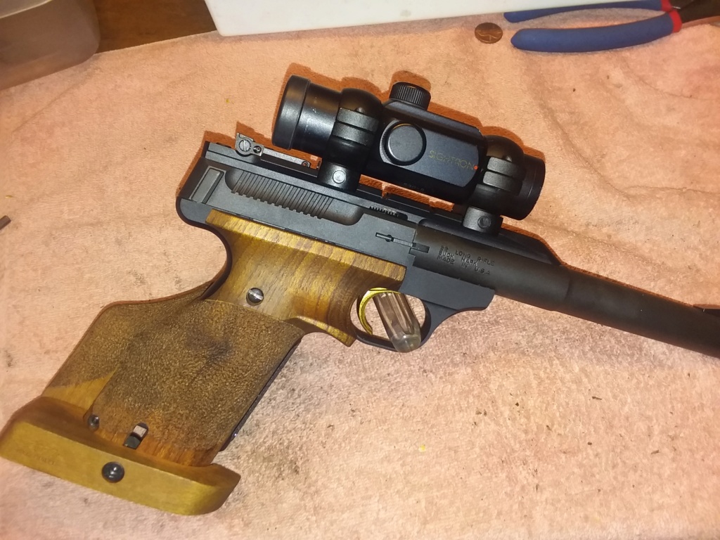

I like the Hunter. They have the same frame as Buckmarks from 20+ years ago. That means that the after market stuff all fits. Nills says their grips won't fit the Hunter. That's only kinda true. Less then 5 minutes of work with a pocket knife to relieve the mag release area on the right hand grip (totally out of sight) and they work great. They also shoot little tiny groups.
Browning Buckmark Hunter for Bullseye? 20190320
Browning Buckmark Hunter for Bullseye? 20190321

LenV wrote:I like the Hunter. They have the same frame as Buckmarks from 20+ years ago. That means that the after market stuff all fits. Nills says their grips won't fit the Hunter. That's only kinda true. Less then 5 minutes of work with a pocket knife to relieve the mag release area on the right hand grip (totally out of sight) and they work great. They also shoot little tiny groups.
Indeed, the frame style was a hugh selling point for me.  I have not fired the pistol a lot since purchase, but it seems to shoot pretty well.  I don't have an issue with it's trigger although it could use an overtravel stop.  I need to find it's favorite load.  Do you dry fire your pistol?  Use snap caps?  I have read where dry firing a Buckmark is not recommended.
