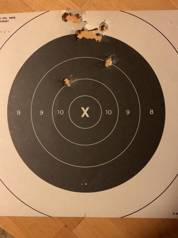

So I went shooting today and was having exceptionally good performance with my 22. I then was doing really well with the 13 twist 45 at 25 yds with 2.9 BE 180 Summers bullets. I decided, what the hell try 50 yds with the 2.9 load.
Here’s my target. I made WAG on clicks up and errored high. Did not spot my shots. They were on call when I checked my target; called the good and the bad
They felt that good but I didn’t think they would look that good considering the light charge. I was pleasantly surprised by the 7 shot cluster.
The fast twist barrels are really forgiving to shoot. It’s been interesting playing with this gun/barrel combination. Next month I’m shooting my first match in almost a year, I will probably shoot this pistol.

Jon, that is really impressive at the long with that load. Is the gun a slide or frame mount? Your hand must be feeling good again.
Stan
Stan
chopper- Posts : 739
Join date : 2013-10-30
Re: First Shots KKM 13 Twist Barrel
Frame mount Stan.
