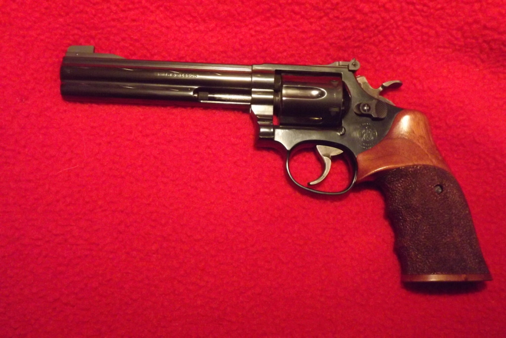

I went distinguished with a 6 inch 686. Mine is a great shooter using various factory 38 round nose 158 grain. It shoots better than my Python.

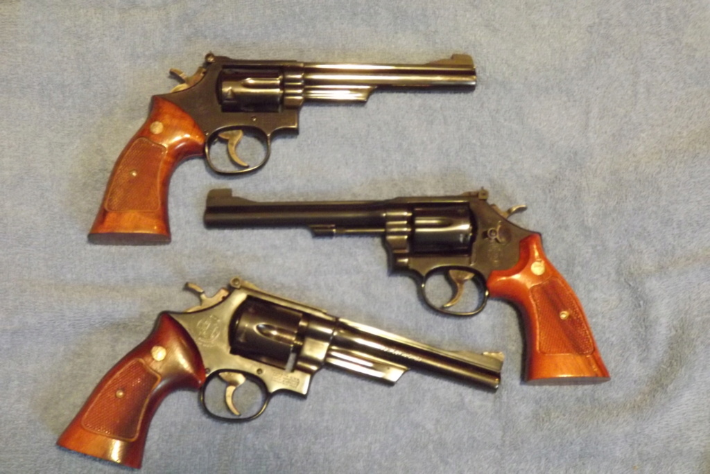

I did try working up a full power .357 mag load for the long line. You can handle anything for 10 rounds. However the 38 special case with a 158gr RN bullet was the most accurate DR legal load I found. I also found zero difference between shooting them out of a 38 special or a .357 mag revolver. Of course all of my revolvers are accurate or they would be gone.
The test pool 19-3, 14-8 and 27-2. Also a 14-6 in separate picture.
