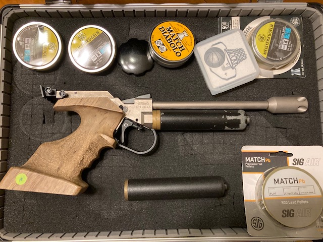

I shortened my cylinders to get a better balance. The threads are an interference fit & I "lightly" tried to use an allen wrench on the brass fitting to get it apart using a 5C collet. Didn't work, so I wouldn't recommend trying to take the cylinder apart.
For those interested: I skim cut the OD until I could just see the brass threads. Then single pointed the metric threads into the shorter cylinder. Holds more than enough for a 60 shot match.
