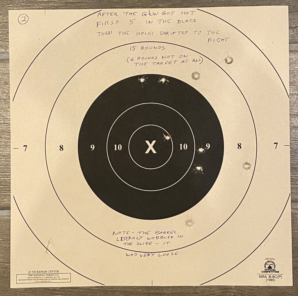

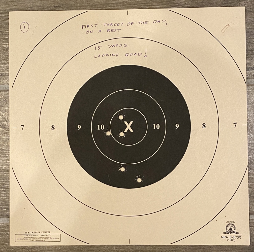

Update. I sent the gun back to Springfield to have it checked out. Something seems to be wearing in an unusual way. The first few targets I shoot are horrible, with the holes all over. Eventually things get better, and the holes fill the black on a B-8 target at 15 yards. Using a rest, the group is about half that size.
I put the gun aside for a while, then shot it last weekend. The first 5 rounds were all outside the black, and most of the holes were not even on the target paper. I had noticed an unusual rattle when the slide was moved back, and it was the barrel moving around. I moved the slide forward, and I swear I could feel movement between the barrel, and the component that serves as a barrel bushing (which the gun does not have).
Other than this minor issue of not being able to hit anything, the gun is awesome. I love the trigger, the gun is very light, and I found that it was just as easy to shoot with one hand as two. With two hands, it feels like I'm gripping it in an imitation Ransom Rest. :-) I bought a pair of grips with more texture, and then found a pair of Hougue grips that I love - just like the stock grips, but prettier, and the wood "digs" into my left hand like sharkskin grips do.
https://www.amazon.com/dp/B001TE3HT2?psc=1&ref=ppx_yo2ov_dt_b_product_details
Anyway, a very nice person at Springfield, Angie, and I had a good discussion about the gun, and they will figure out what's going on. I could guess, but I'm no gunsmith. It must be excess clearance, somewhere, somehow, which is rapidly getting worse.
Wonderful gun - anxious to get it back!!

Let us know what the problem is, assuming SA tells you. You will probably have to talk to the actual gunsmith, as my experience has been, the paperwork that comes back will say something like "fixed".
I will bet service pistol accuracy was five or six inches at 25 yards with ball ammunition. It was more important that service pistols be cheap to make, easy to maintain, and function in all weather. Finicky pistols would be a failure.
There is a genius in designing something that cannot be re arranged incorrectly by the user! I managed to mix internal springs around in my Ruger #1. I confused the ejector plunger spring with the firing pin spring, and found out at CMP Talladega, my rifle would not go bangie! The ejector spring is more powerful than the plunger spring, and that rifle is too complicated to disassemble at the range. Besides, I had no idea what was wrong, I thought the firing pin was broke. Sure explained all the troubles I had installing it incorrectly! But, I could, and that is the crux of the problem.

Update.
I got the gun back, and took it to the range Thursday. The third and fourth targets were nice, after which the grouping vanished and rounds went off the target paper.
I took it back to the range Friday (yesterday) along with a rest. Same thing, got some good groups, after which the gun shot wildly.
So, I took it apart and did a quick clean and lube. Reassembled, and got this target, at 15 yards.
Not wanting to mess up the above target, I replaced it with another, and fired 15 more rounds, five at a time. As I expected the group kept growing larger, and by the last 5 rounds, 7 of the 15 weren't even on the target paper. I notice the gun near the barrel was very hot (probably normal), and with the gun in battery the barrel moved around in the slide (should be impossible), and when I pulled the slide back and shook the gun, the barrel just flopped around wildly as if nothing was holding it in place.
I don't have a good enough imagination to think of any possible cause, other than a cracked slide which was getting hotter and expanding as I fired. Maybe the slide was defective? I dunno. I'm out of ideas. Here's the target, with 9 of the 15 rounds on the target - the other 7 were missing in action. When I first got the gun, and this happened, the rounds were hitting the frame that holds the backing board in place, which made no sense to me....
I called Springfield, and had a very long talk with the tech support person. The gun is now on its way back to Springfield, with the targets, and a long message explaining everything I did, in detail. At the end I added a warning - if my wild guess about a cracked frame is valid, then it might be dangerous to even shoot the gun. I told them to make sure their technician was aware of this, just in case.
I know others are thoroughly enjoying their SA-35, and what's wrong with my gun is probably a defective part. It's obvious when shooting it that something is very wrong. Earlier I tried 147 grain ammo (felt the best), Wilson remanufactured 135 grain ammo (close) and 115 grain ammo (nice, but the heavier ammo was more enjoyable to shoot).

Regardless, as I test fired my gun on the above rest, it invariably flew up out of the rest when it fired. My revolvers behaved much better.
As far as I know, I'm the only one who has posted about this problem with my Springfield. The problem doesn't show up until after firing 20 or more rounds, and it keeps getting worse if I continue to fire.
Maybe someone has a better guess as to what could cause this problem, but to me it comes down to either the diameter of the barrel got smaller, or the hole in the slide got bigger. The only explanation that I can think of is a crack in the slide, allowing it to expand from the heat of firing.
