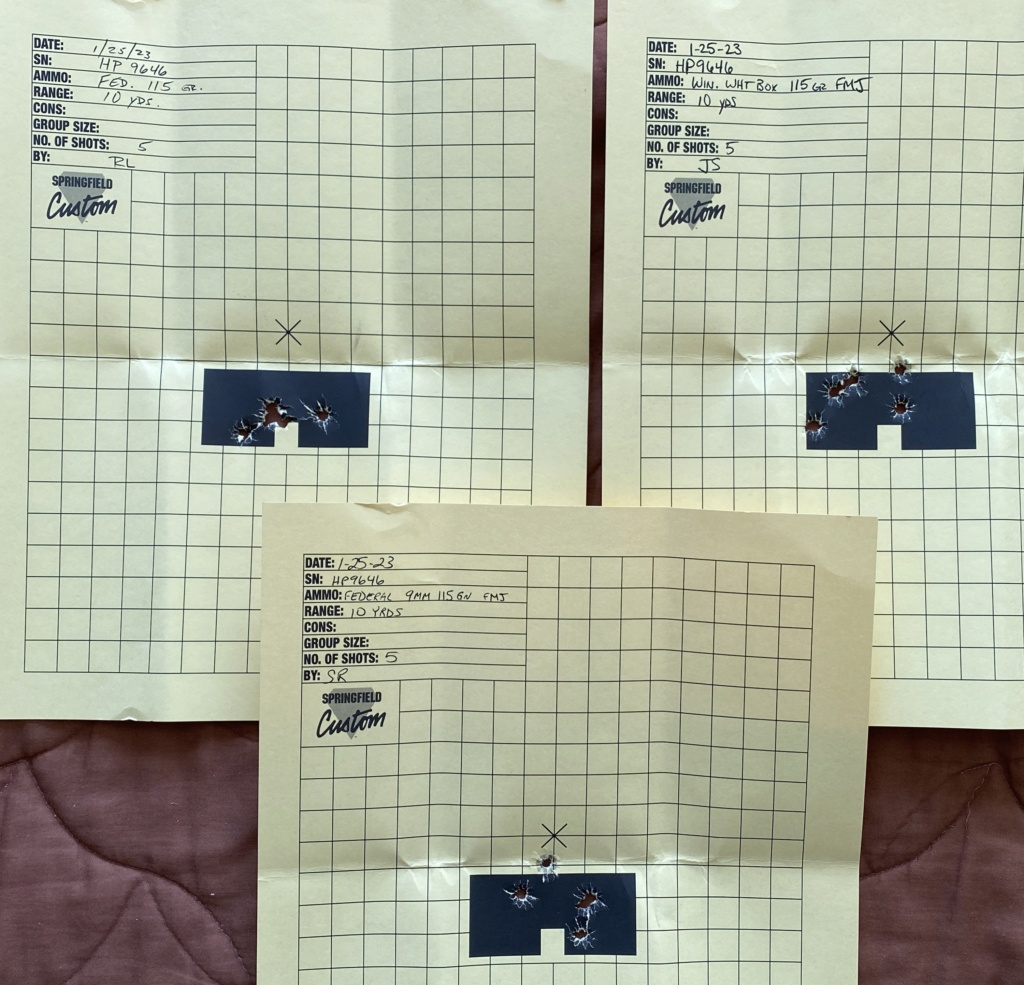

This is my email to Springfield:
My test target - the 9 holes at the bottom were shot from a rest at 15 yards:
......and this is a close-up view of the Springfield test target from my first SA-35, taken at 10 yards:
At least the bottom target shows that some Springfield SA-35 guns are capable of shooting well, but the two that they have sent me are not.
The first one likely had a cracked slide.
The replacement with an 8# trigger pull and probably incorrect parts is worthless.
I'm tempted to use much stronger language, but I will refrain.
I have already bought a 1911 9mm Range Officer Target. If Springfield replaces my gun with one that works, and if they send me a target to prove it, I can turn around and sell it. Or better yet, if they just give me a refund.
Dear Kody,
As I noted below, I wasn’t able to get back to the range until December. The gun looked great, and I was anxious to shoot it.
However, over the course of much of December, neither I nor anyone at my range was able to shoot it. The trigger pull (8 pounds) was much too high, and I thought that was the problem. Then over the past two weeks, I found that nothing I could do, even shooting with the gun locked into a rest, could get it to shoot well.
I took it to my local gunsmith several days ago - he told me that while he had oiled it, it was never going to work properly because the parts in it are wrong. After he oiled it, the gun was, and still is, a 7 pound trigger pull.
Nobody (including the fellow who won our recent Bullseye Match) can shoot this gun with any accuracy. I assumed this was due to the trigger pull, but on an expensive gun rest, with the front of the gun locked in a “vee”, the grouping is awful. There is no “group”. I attached a copy of my test target, and the Springfield test target for the previous SA-35 that had a different problem.
As I mentioned to Drew on the phone, I just bought a Springfield 1911 9mm. It will be delivered next week on Tuesday. I need to return this gun and get a refund, or get it fixed so it shoots the way it should.
I am attaching my test target from yesterday. The top hole was shot at “center hold”. The other 9 holes were shot at sub-6-o’clock hold - I was using 115 grain Magtech ammo which the magazine reviews recommended.
Please send me a mailing label so I can return this gun. If Springfield can fix it and send me a test target, you can return it. Or, please refund my purchase price.

Absolutely NOT. Did you look at my target I posted? And that target was on a rest.spursnguns wrote:Hello mikemyers,
Please confirm....
Your mass-produced service-grade pistol, which come with no accuracy guarantee, is shooting a ten ring size (approximate) group at fifteen yards with no ammunition testing or adjustment.
The other target was at 10 yards, and it was shot at Springfield, on their rest. All I know is what you see on the target. Do I trust it? No comment.
