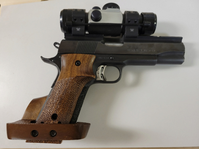

So I have a couple early Gold Cups and had them out this morning to do some ammo accuracy testing and recoil spring tuning.
First is a 1971 GC (70N02118) that the prior owner worked into a wad gun. It had been drilled/tapped for a Bomar/Clark rib, forestrap stippled, full-length guide rod, hammer bobbed, beavertail installed and a Kart barrel installed. I sent it to KC Crawford who tuned the trigger (I had installed an EGW hammer/sear), installed a Dlask trigger and did some work to the barrel lockup and throating. Apparently the barrel had been poorly fit and the chamber not cut right. On top is a Matchdot in Vortex Pro 30mm rings on a Clark rail.
