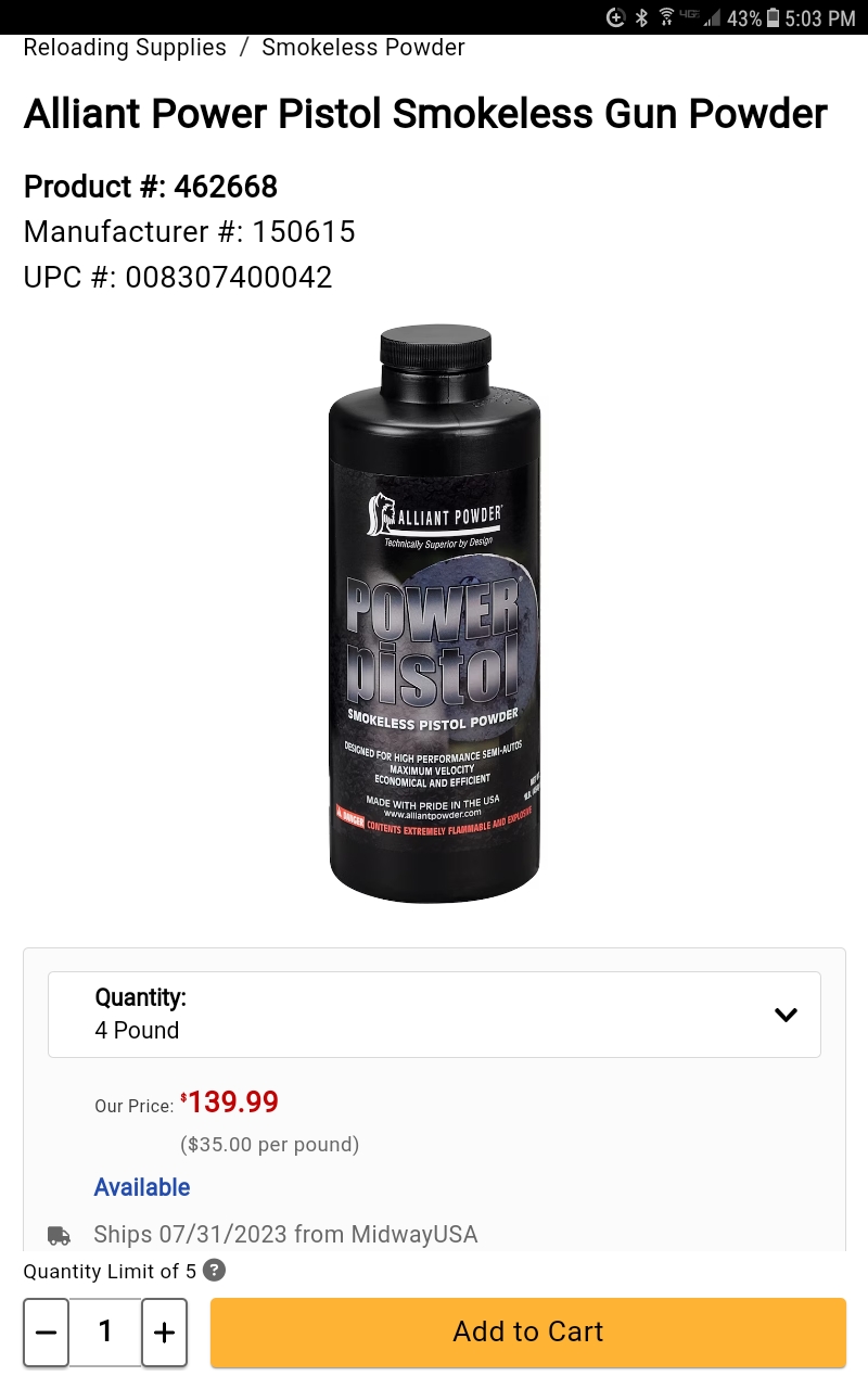

I’ll also try some Tightgroup and Power Pistol powders.
