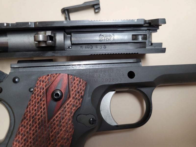

So I jumped at an opportunity on GB where a shop was selling a SA but didn't advertise it as a RO, just a 1911 with mods for $600.  I called SA and verified the serial as a RO.  It has old Colt medallion grips (already swapped) a Wilson lowered thumb safety, arched mainspring housing (already swapped) and a short, solid trigger without overtravel screw.  I picked it up today and it sure hasn't seen many rounds, like maybe a few hundred.  Not even the normal aw-shit mark behind the trigger from putting the slide stop back in.  Trigger has a great feel with a consistent break at 4# 4-6 ozs.  I did notice something that generates a question, though.
The slide has a different number stamped into the track under the extractor, but the frame's serial number is vibra-penciled into the disconnector track.  Slide-to-frame fit is excellent, so I am nothing but curious about this.  For those of you who have worked a RO or 20, is this something done at SA, or was this done when the trigger/MSH work was done by a gunsmith?

Not sure what the stamped number is, but the ep’d number which matches the frame number is applied at the factory. All RO’s I have worked on have this number on the disco rail. One of the first things I do is smooth this area with a fine stone. Their rough ep mark sure feels gritty as it passes over the disconnector, knocking off the high spots improves it greatly.

My assumption is that they have tons of frames and slides. Each numbered differently. When their smiths mate slide with frame they mark frame's number on a slide for a matched set. Just a guess. All good, you got a great deal.

I can't see from the picture - which hammer does it have?

adminbot1911 wrote:I can't see from the picture - which hammer does it have?
It has the original "Delta" hammer.  I have an EGW lightened hammer to put in, should it have needed it, but I am not messing with the current trigger feel.
Everything except the trigger, thumb safety, grips and MSH appears stock.  I already replaced the well-worn Colt grips with G10s and the MSH with an EGW 20lpi checkered.  Trigger is in question.  I can make it work as-is, but prefer a longer one.  Otherwise, I'll shoot it as-is unless I get light hits, then will replace the Ti firing pin/spring.
New BarSto barrel is in-hand to send to KC when he is back at it.  I'll let him fit a new trigger/hammer/sear, thumb safety and 20lpi checker the front strap when fitting the barrel.

Nuke, I'll bet Kp321 is correct about the last 3 digits on the disconnect ramp, a good way to match slide to frame after having proper fitment.
 I went the same route as your taking only I had Jon Eulette do my barrel fitting, which is very important for a great shooting and long lasting pistol.
 I'd say KC is good at that also, and triggers are a must, I prefer a short to medium roll, they are both "kings" at those. Price wise I'd say they are both comparable, and well worth it.

chopper wrote:Nuke, I'll bet Kp321 is correct about the last 3 digits on the disconnect ramp, a good way to match slide to frame after having proper fitment.
Stan
Yeah, the MIL match guns (rifle & pistol) all had last 4 engraved on pretty much every fit component.  On the 1911s, I saw numbers on slide, underside of barrel, sometimes on bushing skirt and magazines.  M14s had numbers on bolts, oprods, gas cylinders, barrel channels in stocks, rear sight bases, trigger housings, hammers and magazines.

My RO slide is marked exactly as yours.  Last 3 digits of serial number matches the 3 numbers penciled inside the slide.  Shot 10 ring at 50 right out of the box.  Trigger needs a little work but thats OK.

PMcfall wrote:My RO slide is marked exactly as yours.  Last 3 digits of serial number matches the 3 numbers penciled inside the slide.  Shot 10 ring at 50 right out of the box.  Trigger needs a little work but thats OK.
Phil
My Wad Gun was marked like that, RO Barrel with a NM Fit bushing was a 10 ring Gun. I had a Kart installed and it shoot better but not much.
