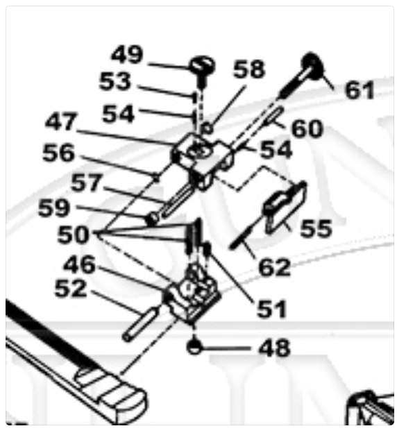

Post by inthebeech Wed May 25, 2022 4:55 pm
Is very stiff; enough that a nickel will pop out of the screw head if you don't really bear down while adjusting.  It looks like the same staked on style of nut opposite the screw head that you get on S&W revolvers.  Lube is not helping.  Gun is 99% and no signs of abuse anywhere.  I need to free up the movement a bit.
Thoughts about cause and remedy?
Thx,
Ed

Post by mikemyers Wed May 25, 2022 5:28 pm
I'm sure there are better answers, but the last time I had something like that, I put a small amount of penetrating oil on the gun, and left it overnight, so it could find its way to where it was needed.  I think that suggestion came from someone in this forum, but it was many years ago.  It did work for me.
Does this help?
Model 41 (1980's) windage adjustment... Scree108
Posts : 4139
Model 41 (1980's) windage adjustment... Empty Re: Model 41 (1980's) windage adjustment...
Post by mikemyers Wed May 25, 2022 7:05 pm
One more thing - once you lubricate it with penetrating oil, do NOT try to turn the screw all the way in or out.  Just wiggle it back and forth, and once it starts to turn just a little wiggle it more, so each time you are turning it more.  Maybe add more penetrating oil.  Once it starts to move, it should/may eventually free up to where it works normally.  You don't want to break anything, so be gentle.
Posts : 4139
Post by fc60 Wed May 25, 2022 8:11 pm
Here, Kroil is your friend.
As Mr. Meyers commented, just wiggle the screw forth and back just to allow the Kroil to work.

Post by troystaten Fri May 27, 2022 1:42 pm
You might also lightly tap the screw with a small brass hammer, the key word is lightly.  This can brake any rust and allow the oil to penetrate.  Be very patient and take your time.

Post by mikemyers Fri May 27, 2022 3:24 pm
I suspect Kroil is just as good, if not better than penetrating oil, but I bought a small bottle of penetrating oil with a "needle dispenser" making it very easy to apply exactly where I wanted.
Yep, patience is key.  A small brass hammer with a punch is likely to help a lot, but don't "hit it", just give it a light tap.
I never tried this, but if you're using Kroil, maybe you could remove the barrel and dip it into a small cup of Kroil, and leave it overnight?
