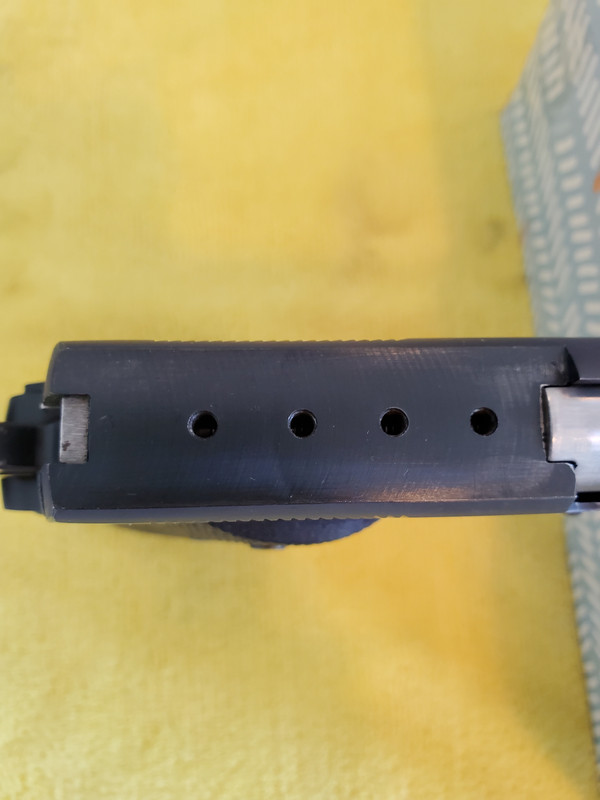

This is my Clark .38 WC gun built on a SA NM frame and Colt Kit slide and barrel.  It is marked "1.74  J. E. Clark  Shreveport LA  3.65" on the inside of the slide and it came with 4 magazines from Clark's shop.
I haven't shot it yet (but I will) but I would like to know if the milling and d/t on the rear of the slide were for a flat-bottomed Bo-Mar sight?  I know I've seen pictures of Clark guns with such a sight mounted, and if possible I would like to obtain and install one.  Can anyone confirm that there is such a sight?  And, the big question--does anyone have one they could part with?

That slide flat cut is for the Bomar Mini-rib rear sight. They are very rare and expensive to find replacement mini-ribs. Last one on eBay was $200+
The numbers under the slide are the month/year of build and serial number of receiver. The numbers do not match your receiver and receiver is missing tiger tooth stippling on the front strap. So slide was taken off original receiver and put on the SA.

Dave, standard Bomar rib has radiused bottom and mini-rib has flat bottom. I haven’t seen a higher mini-rib (45 only pistols?)off a pistol in so long I can’t remember if flat bottomed or not. Then we have the tuner issue. Every Clark 38 I’ve seen with mini-rib has always had barrel fit to the tuner. So the adaption of a full length rib would require machining the bottom flat, drilling the mounting hole pattern to match existing slide holes, and machining the tuner. Probably easier to fabricate new base and using new Kensight leaf/blade.

I need to get new glasses. I see the flat in the first photo. I machined a mini rib scope rail for a friend to replace the Mini-Rib. Had to machine the hood radius "just right".
