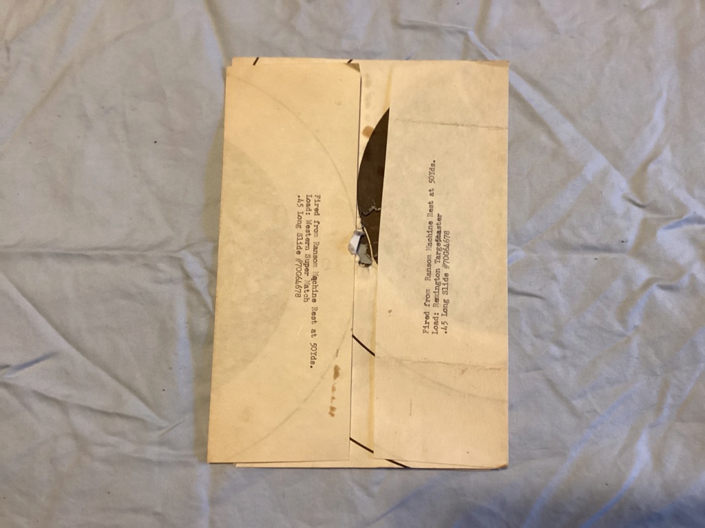

Post by Cmysix Sat Dec 31, 2022 7:54 am
Jon Eulette wrote:This is a typical series 70 colt long slide. It has a Bomar mini rib so it is not considered a heavy slide because it does not have a full length rail. Curious if your barrel has any markings on it? Or is it a two piece barrel? You would see a seam where a new barrel was stubbed into an old Colt  barrel.
They have been selling on gun broker for $1400-$1600.
OKAY, are you ready! The barrel says. smith&wesson u.s.a. MTU.   And here is the targetsOut of storage 30eab010
Out of storage D1b16c10
Out of storage A0547510

Post by james r chapman Sat Dec 31, 2022 9:49 am
Provenance!!

The MTU barrels shot excellent. I’ve had a few.

MTU= Marksmanship Training unit, back in the day S&W made barrels for the MTU to a given specification. In they day it was a very good barrel and likely still will shoot well. Clark did a bunch of different things over the years and today many of his guns have had additional modifications from other smiths, so hard and fast rules don't necessarily apply. Your gun likely will shoot swc as well as any from the time period.

MTU barrels came in 6”. Armorer’s cut them down to 5”.
Clark used to sometimes make two piece barrels; typically 38 spl.

This pistol was accurized to shoot NRA "Conventional Pistol" now called "Precision Pistol" matches. It is built with the intention of shooting .45 ACP caliber ammunition with 185 grain or 200 grain bullets and a reduced powder charge in what are called 2700 matches, where the maximum points that can be obtained is 2700 (has never been done in registered matches). Further, these matches are shot with one hand, outdoors, at 50 and 25 yards. Wadgun refers to the type of ammo that the pistol is intended for...wadcutter ammo. Those 10 shot test targets were fired from a machine rest at 50 yards. Clark Custom has long ago lost their interest and knowledge of these guns. I was hoping that they might have had some records to help you, but apparently they either don't have the records or are not interested in taking the time to look them up. When Jim Clark, Sr. was alive, things were much different. I can say that from personal experience.
Back when this pistol was sold, hardball pistols, referred to DCM; later CMP matches which were shot with pistols that except for adjustable sights, looked externally like the current military service pistol of the period, now referred to as a 1911 (1911a1). The maximum barrel length was 5". Competitors used 230 grain, full power, factory .45 ACP ammo in these pistols. Matches were shot with one hand at 25 and 50 yards, but were of only 30 shots. The top 10% of shooters at each match were awarded points (depending on how they placed) towards the much coveted Distinguished Pistol Shot Badge. There were other rules, limiting the number of matches that could be entered and regarding the pistol used.

Jim Clark Sr. Built MANY longslide 1911s and his joining of the slide extension to the slide is excellent and, no doubt, accompanied by similarly excellent re-bluing.
That 1911, or more-correctly Colt's Government Model, MkIV Series 70, was not a military pistol. Aside from competition or "special application", Uncle Sam has never issued a 6" barreled 1911. The MTU barrel was probably sourced by Clark when S&W produced them for the MTU (now USAMU), just as 'smiths now procure Kart, Bar-Sto or KKM barrels.  Every so often a manufacturer has overrun from the contract and sells them.  Clark most likely had this barrel in the "45acp 6" barrel" bin when it was this pistol's turn on the bench.
