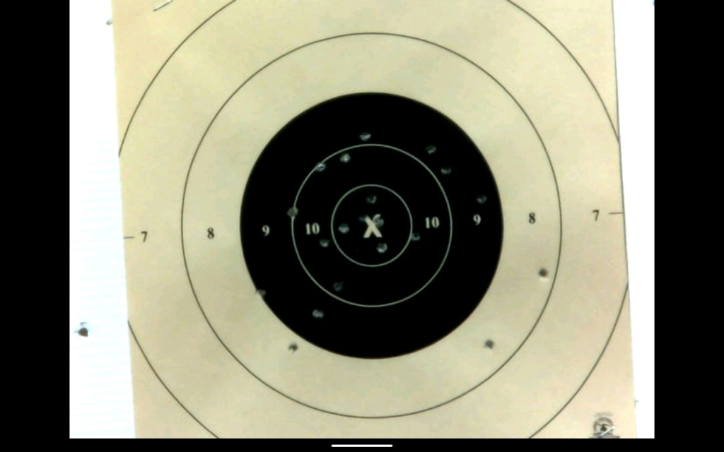

I use a Wyze Wi-Fi camera mounted on a tripod for 10m indoor air pistol shooting. It displays the target on cell phone. The imaging is clear and easy to see the holes appearing real time. The unit was pretty cheap and was easy to set up and use with the app. I found it works best positioned in front of and just below the target bull - so that it is looking up. The resulting image is slightly distorted because of that upward look but not by much. It is much easier to use than a spotting scope IMO and is like a poor man's electronic target system minus scoring capability. I don't think it would work for longer distance outdoor shooting since it requires Wi-Fi.

This is the camera I was referring to earlier - which one of it's purposes could be a baby monitor. In my application I'm using it to monitor my target instead of a baby - but I might call it my baby if I shoot high enough score. Has mount compatible with camera tripods. This is handy way to position it. Note that I was responding to the OP which was inquiring about something to use for indoor 10m AP. I don't think it would be suitable for longer range pistol shooting which the other posts seem related to. I agree that in that case a scope adapter would probably be the best way to go.

The Longshot Hawk, which attaches to a spotting scope, has its own built-in wifi transmitter. It will hook up to a phone or tablet. I believe its wifi range is about 50 feet or so - plenty far enough.
I got a cheap phoneless Android tablet off Amazon. It works great with the camera.
The outfit is as good as the spotting scope you are using. I can see .22LR hits with no trouble at 25 Yds. It does pretty well at 50 yds, but I have an inexpensive scope (20x-60x X 60mm), so some shots don't show up in the black sometimes. I need to spring for a scope with higher quality optics. No problems seeing shots from my Mod 52-2 and 1911 in.45 acp .
I also have 2 of the the LR3 (2 mile range) cameras and 1 receiver I use for rifle. Works wonderfully. The LR3 is no good for bullseye pistol, what with berms in front of the target holders and all. The camera is necessarily too close to the target to get it properly in frame.
Another plus with the Hawk: you can take pictures of the bullet-ridden targets. A nice feature.
I'm on my 3rd season with the Hawk and 2nd with the LR3. I use one, the other, or both every time I go shooting.
