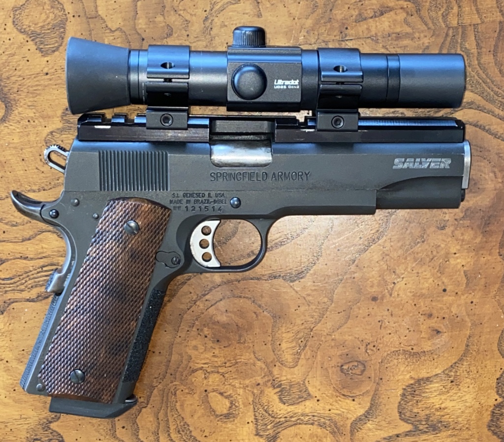

Lots of shooters use different guns for .22 and .45, for example your Model 41 and a .45 1911. But many also use a modern .22 1911 conversion ( Marvel or Nelson) for a .22. You will find that most shooters don't use a centerfire caliber, the majority just shoot .22 and .45.
I wouldn't feel rushed to use red dots, you already have some great guns ready to go. I would start with what you have, and allow youself to get a feel for things. You can get replacement barrels for either your 41 or High Standard that are set up for red dots, that way you don't have to modify original equipment. Or you could buy a Marvel or Nelson conversion.
Then you could shoot one of your iron sight 1911's for now, while you are in the process of building up your Range Officer.

The rationale for a dot isn’t just because it helps your score; it also helps you train. A dot shows your actual wobble, how it starts then diminishes and how it disintegrates. It also shows what the gun does when you pull the trigger. If you have a problem with trigger control, you’ll see an indication with what the dot does at release. If you only shoot with a dot on your 22 you’ll get a better training experience.
