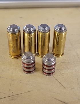

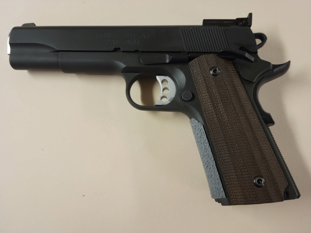

In the quest for my final 10 Service Pistol leg points (my first 20 were from the early 90s), I decided to chase the rabbit down a hole and bought a 9mm Range Officer.
Then I decided to have it converted to 38super. I shot a 38supercomp Open pistol in USPSA and absolutely loved the reliability of feeding that rimless, long-ish brass in the 1911 platform. Off to Jon Eulette it went. A KKM 0.355" 1:16" twist tube got fitted, trigger job done, slide needed just a smidge of tightening and back it came. A NukeMMC stippling job and it was good to go. Initially I ran it with 115gr HAP bullets and 5.2gr of 231 to loosen it up and have good accuracy at 50yds.
About that time, CMP decided to change rules on me and allow lead bullets. SO I chased that rabbit just a bit deeper ... bought some 125 and 150gr SWCs. Hmmm ... a 0.356" 150gr Brazos SWC with 3.2gr of Titegroup or 3.0gr of Bullseye was quite pleasant in sustained fire. Well shoot ... seems to me 148gr isn't far from 150gr ... and 0.358" isn't far from 0.356". If my Ed Brown magazines release the round late enough to guide into the chamber but soon enough to not be cock-eyed on entry in the chamber, maybe I could use some of these H&G 50 wadcutters I have laying around ...
So a little loading was done. I have 24 loose pieces of Starline 38sc brass. 4 got loaded with 3.0gr of Titegroup. 20 got 2.7gr of Bullseye (gee ... sounds like a 38 special load
Cycled them thru the pistol by hand. Since these bullets were designed for semi-auto 38spl shooting, this shouldn't be a surprise. All went thru just fine, so let's give it a go.
Shot them at 25yds today. Here's my 2nd 2 mags of the 2.7gr BE load in a TF cadence. I think if I can get these bullets sized to 0.356" and tune the load a bit, this answers any need to try and fight a 38spl 1911 build and locating the uber-expensive magazines. The Ed Brown 38super mags are $28. This load doesn't quite lock the slide back, but it completely cycles. Another 0.1 or 0.2gr and we're in business.
Does it shoot soft? You tell me ...
https://youtu.be/zVbbf-pu1NE
So now this is a CMP EIC legal service pistol that is essentially a 38spl wadcutter, only 1/8" shorter and significantly less expensive.
